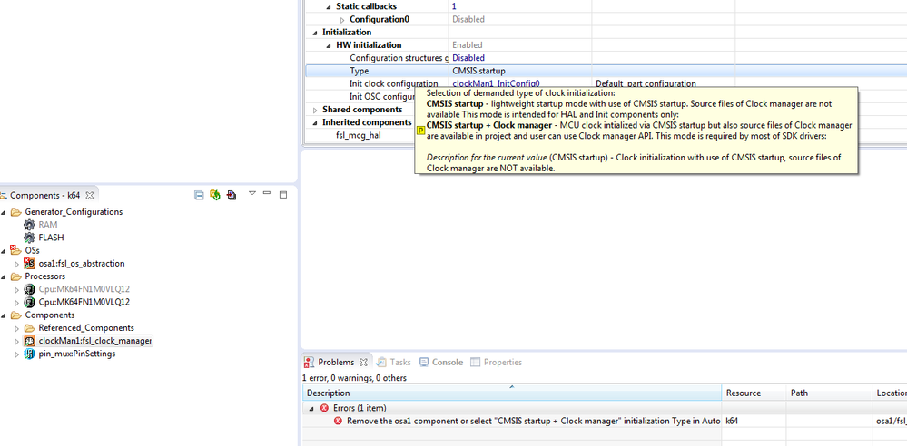

I'm trying to work with a MKV30 processor
It looks that is not possible to remove osa 1:
If i remove it the fsl_clock_manager component complains,if i remove it then the CPU component complains that the latter is missing.
I found an example for KSDK 1.1.0:
Low power demo application on FRDM-KL03Z board with KSDK 1.1.0
but it does not works to me in KSDK 1.2.0.
The CPU component has few options compared to the one in  the example
The CPU component needs a fsl_clock_manager
The fsl clock manager has the "Share components" checkbox flagged and disabled,and it is shared with osa1
Thus the CPU can only work with fsl_os_abstraction osa1
it looks that there is no  escape.
I'm i wrong?I hope yes

this is possible when you switch clock manager to CMSIS startup code (Hardware initialization group). In this case only HAL components can be used.
Generally it is possible to have PEx projects without OSA from 1.2 but with limitations mentioned above. These limitations are caused by KSDK itself.

Thanks Vojtech Filip,it works as i need.
Diego
