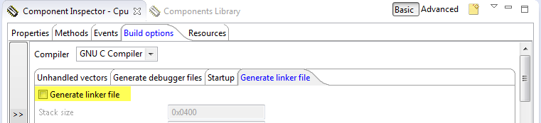

Is it possible to use Processor Expert AND be able to force a few functions into a special memory area? I am facing the two following problems:
1)     I can create a new memory area using the "generate linker file" option of processor expert. I can also define the selected code to go into a special section using the "section" attribute, but I cannot find a way to allocate that section into the specified memory area while at the same time keeping the basic linker file created by Processor Expert. Is it possible to either add a special linker file to deal with just that code, or to modify the Processor Expert linker file in a way that won't be obliterated every time I regenerate the PE code?

1) The best way is to generate Processor Expert linker file the first time and then disable Linker file generation:
This way you can make all the changes you want without worrying about PEx overwriting the linker file. About code and variables relocation you can refer to the next document in the community and MCU on Eclipse blog:

Solutions 1) and 2) work!
