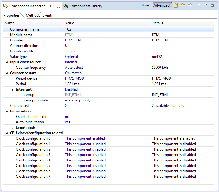

Well, I have managed to solve it but I still need some support to clarify the issue. Besides the Capture_LDD component I'm also using two TimerUnit_LDD components. Both of them set as timer counters with ISR interrupt enabled (every 1.024ms and minimal priority). Here's the TU1 and TU2 configurations:

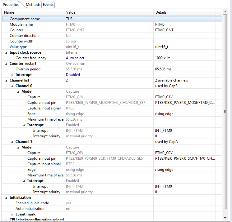

TU3 is referenced by the 2-channel Capture_LDD component and here's the PE configuration:
As I mentioned in previous post, when the TU1 and TU2 are enabled, I observe some missing pulses on the 40ms signal period. Disabling TU1 I still observe missing pulses. But just by disabling TU2 everything goes perfect! No missing pulses are observed. Why? Could anyone give me a hint?

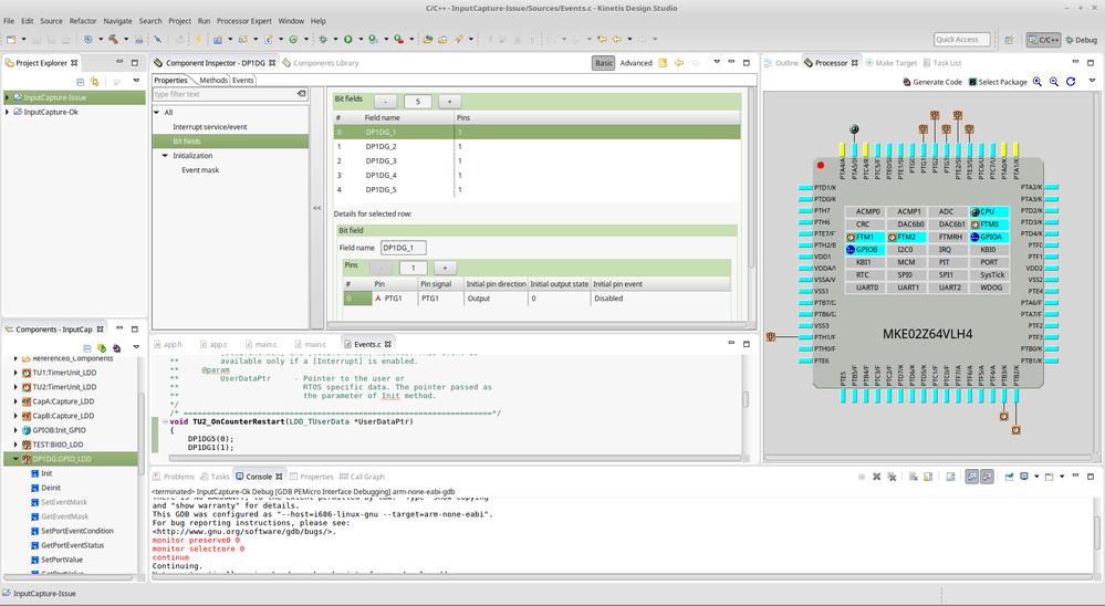

On the InputCapture-Issue project I've implemented TU2_OnCounterRestart ISR with 5 GPIO outputs setts. In this case, these GPIOs are defined using PE as a GPIO_LDD group-of-bit-fields component (see next image)

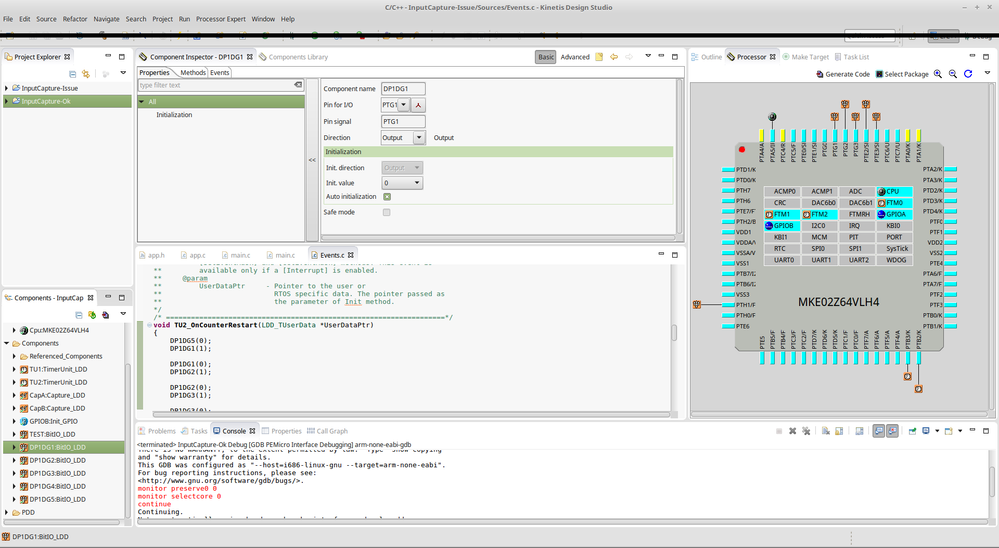

In contrast, on the InputCapture-Ok project the 5 GPIOs are defined as single BitIO_LDD components as shown:
For the InputCapture-Ok project GPIO implementation I see no missing pulses on CapX_OnCapture ISR routines. Obviously, I can not say the same in the case of the InputCapure-Issue project as I can detect missing pulses.
