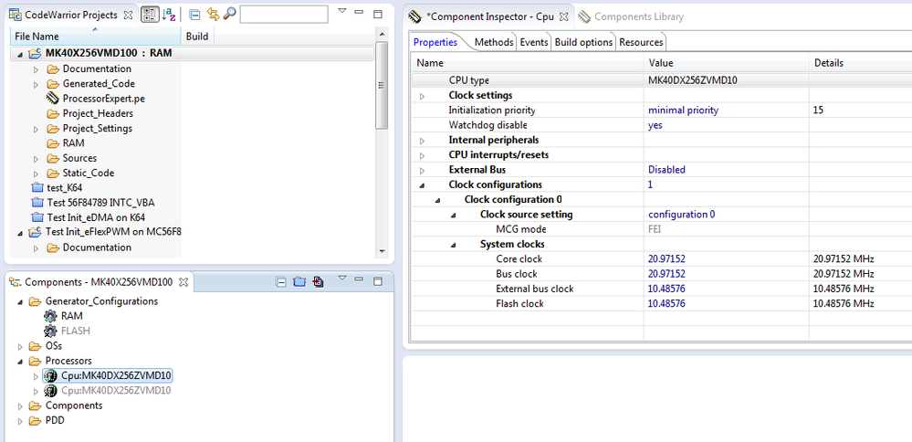

I'm using the TWR-K40X256 board and it has a MK40X256VMD100 MCU.
I want to use processor expert to configure it. But I can't find the MK40X256VMD100 in processor expert.
What should I do?

The MK40X256VMD100 is an obsolete name of the derivative. The current name of this derivative is MK40DX256ZVMD10.  Please, create a new project with MK40DX256Z derivative. Then select the CPU type (in the Component Inspector of the CPU component) MK40DX256ZVMD10, see also the following screenshot:
