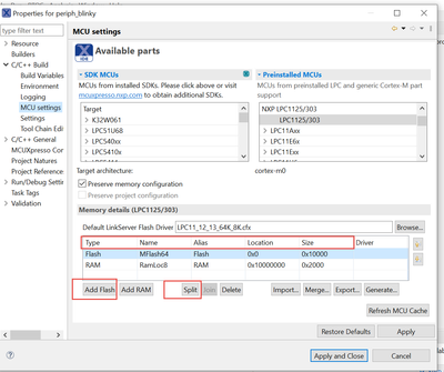

Hello @matteocrulli92 ,
You can use your own code to config, also can use MCUXpresso IDE, there is peripheral tool to configure, or refer to the generate code:
https://www.nxp.com/design/software/development-software/mcuxpresso-integrated-development-environme...
