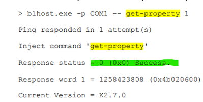

Hello, maybe you could try with BLHOST and send the command get property.
blhost -p COMX get-property 1
MCUBLHOSTUG.pdf (nxp.com)
Pavel

Pavel_Hernandez
Pavel
