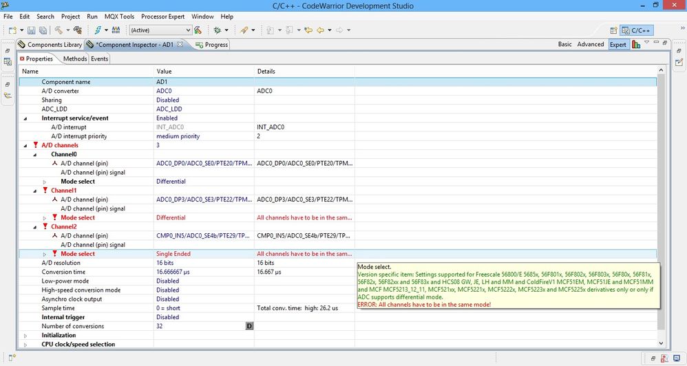

I already used it in differential mode only. But when I configured the ADC with differential channels and single ended channels together, the processor expert reported me an error: “All channels have to be in the same mode!”. I was using the FRDM KL25Z.

please use ADC_LDD component instead of ADC. The ADC is a component from a "high level" component set member that comes from older architectures (HCS08, HCS12) and it has the limitation that differential and single ended channels cannot be used together. On Kinetis the ADC component methods are using ADC_LDD anyway so if you use ADC_LDD directly, you will get a little bit more effective code.
For examples of ADC_LDD usage, please see the 'Typical usage' page in the help (you can see it using 'Help on component' pop-up menu command for the component).

kgouveia
Where can I switch the result type to Raw or signed/unsigned 16-bit? I'm using CW 10.4.
Here is my component inspector view and the ProcessorExpert.pe file:

Petr_H
The advice from Vojtech regarding the types was intended for ADC_LDD. In the ADC_LDD there is a property Result type.

kgouveia
Hi Petr,
It's great! Now I configured my ADC and worked!
