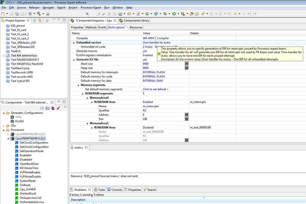

Hello Kiven,
When you want to generate one ISR handler for each interrupt vector (to check what ISR cause the problem) select the value "Own handler for very" of "Unhandled vectors" property in the Build options tab in the Component Inspector of the CPU (you have to select the CPU component of the PEx project and open the Component Inspector). See also the screenshot below:
