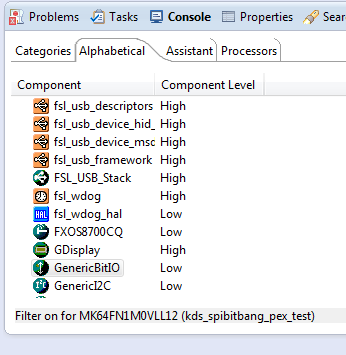

So I decided to move on to try the GenericBitIO component in KDS+PEx.  Setup seemed clear enough until I saw this GUI:
I already set the Direction under the Component Name, so I don't understand why I would have to set something in a Direction tab.  In addition, I tried to figure out the significance of PTADD_PTADD0, but I can't find any part of that in the reference manual.  Also, the checkbox should really just be labeled "Output" or "Is output".

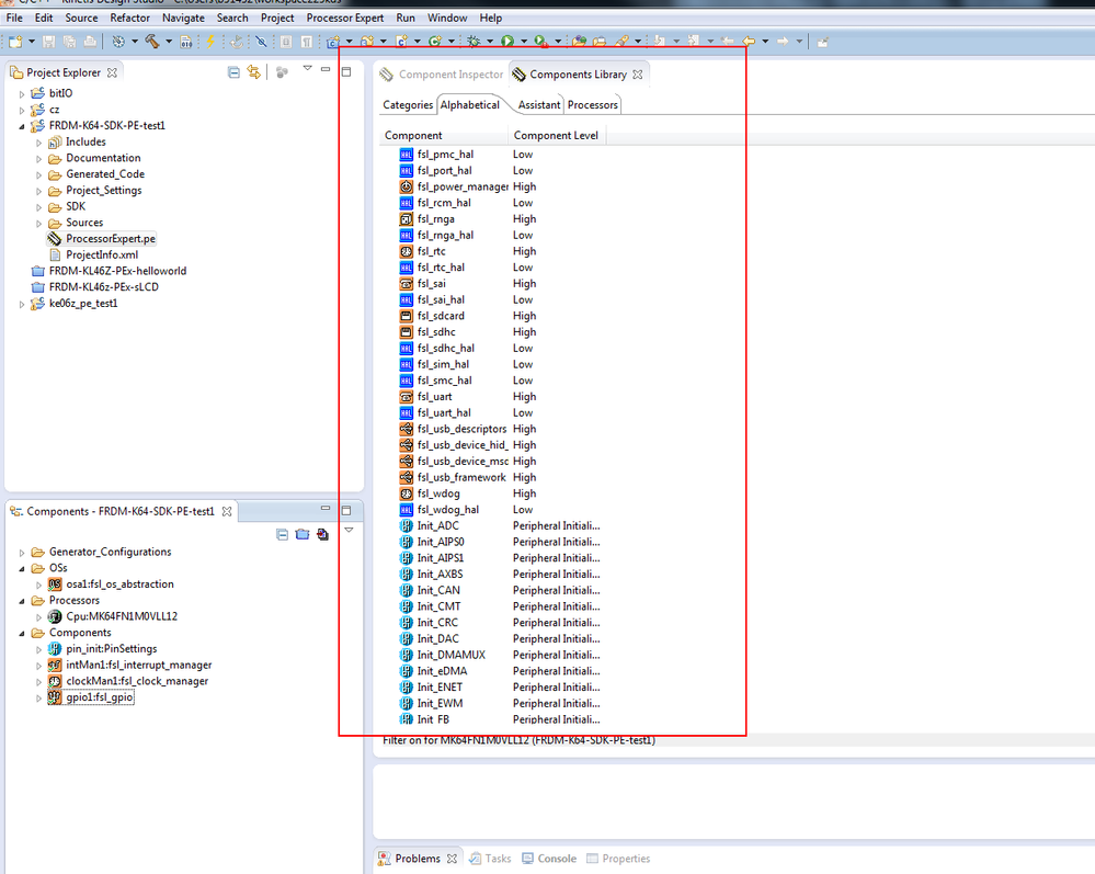

Hello Dave,
I have some doubts. Please see my screenshot :
this is my fsl_gpio component, we can select port in "Device" , and on my side , there is no GenericBitIO component , could you please screenshot yours , like this :
1,424 Views

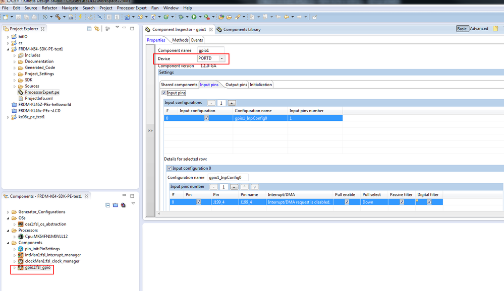

dave408
Senior Contributor II
Alice, I can select the Port just fine.  But like I said earlier, when I click somewhere else and come back to the the Device selection, it changes back to PORTA.

vfilip
the Device item should not be visible. It is problem in PEx for KSDK 1.1.0 (already fixed in PEx for KSDK 1.2.0). As workaround please ignore it or switch to old inspector view (details attached).
We are sorry for inconvenience.

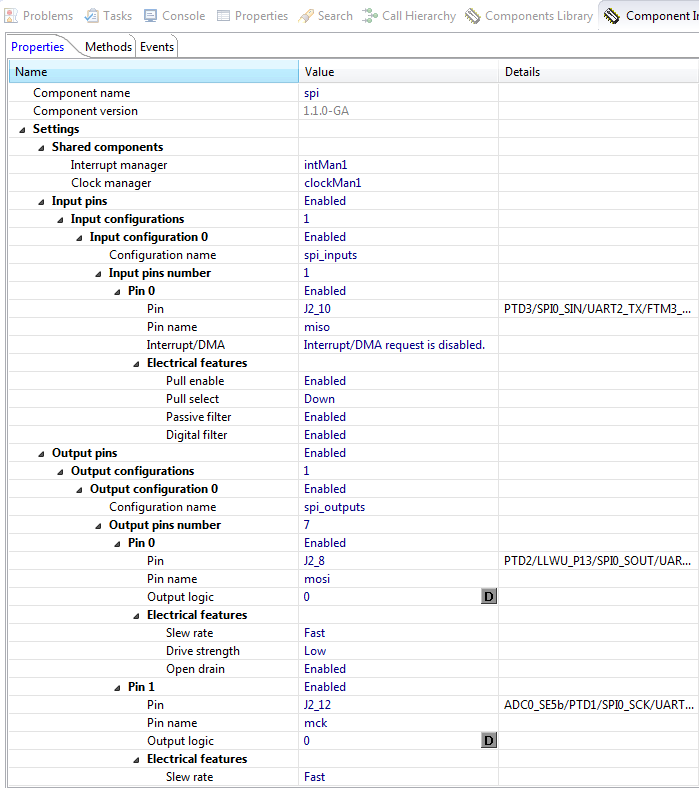

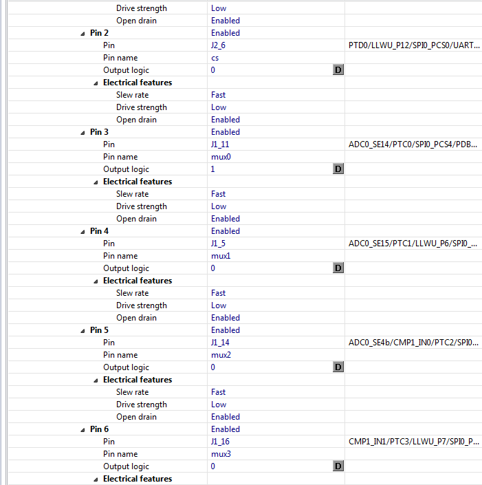

Hi Filip, back to my problems with fsl_gpio -- I am probably doing something really dumb, but I cannot get fsl_gpio to set any digital outputs.  Here is what my configuration looks like in PEx:
I thought that maybe I had to set the pin directions manually, despite the PEx settings, but I just confirmed by stepping through GPIO_DRV_Init and seeing it configure the directions for the one input (MISO) and the seven outputs (MOSI, MCK, CS, and four MUX bits).
But when I step over GPIO_DRV_SetPinOutput( mux0), where mux0 is an output bit, the corresponding pin J1.11 on the FRDM-K64F does not go high.
Can you suggest anything for me to check?

Jorge_Gonzalez
Dave:
Set the "Open Drain" setting to disabled in all the pins, unless you have external pull-ups.
1,424 Views
dave408
Oh man, how did I miss that...  thank you.

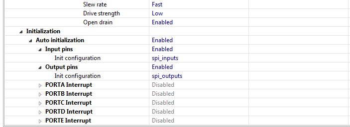

dave408
Yong, disabling tabs view definitely made it easier to figure out how to get fsl_gpio to work.  However, it looks like I cannot have two fsl_gpio components in my project, even though they use different ports.  My "mux" fsl_gpio component uses PORTC, and my "spi" fsl_gpio component uses PORTD.  If I have only one enabled at a time, PEx can generate code.
However, if I have both enabled, I get a PEx error popup when I try to generate code.  It tells me to look in the Problems window for more details.  Then the Problems window tells me to check the Component Inspector for errors.  When I go to the Component Inspector, there are *no* errors.  However, the Components window shows red Xs on each of the fsl_gpio components, but no additional error information.  So I can't figure out how to get both working, and thought that maybe this is a limitation in PEx and I can't used more than one at a time...  ???
