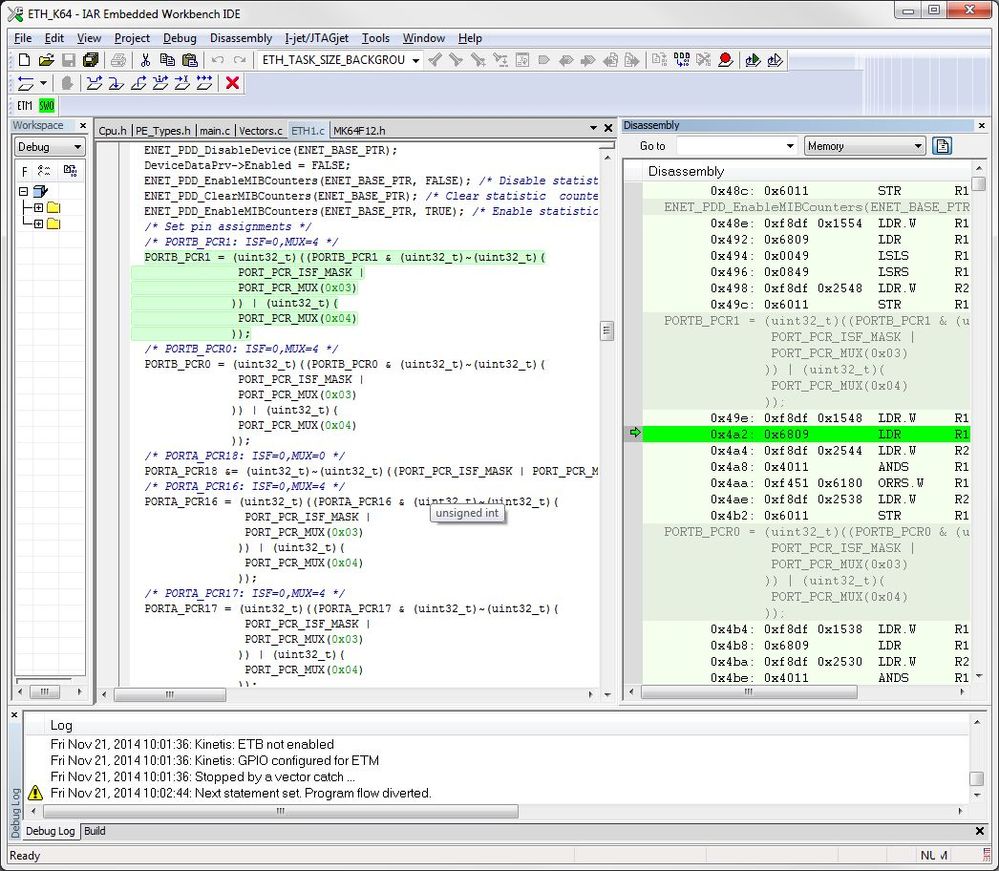

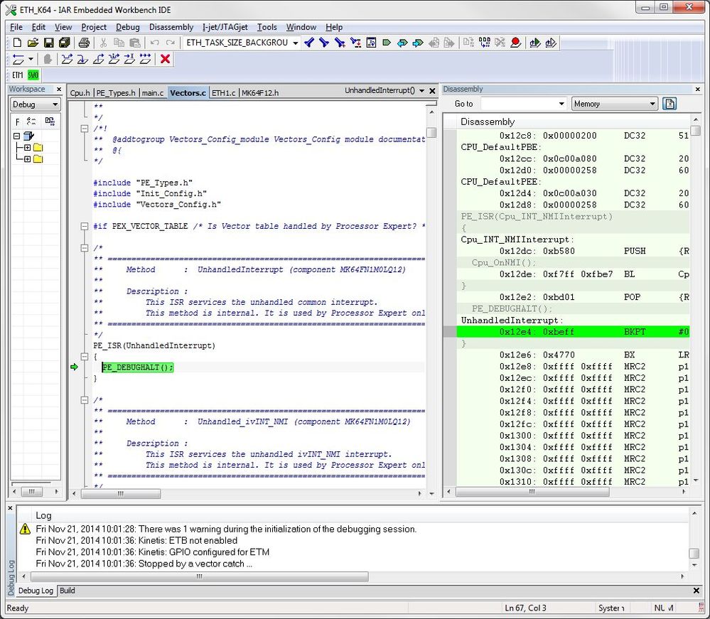

When running init method of ethernet LDD, a hard fault occurs due to missing clock gating of a port.
This can be reproduced easily and a test program is attached.
Processor Expert Driver Suite 10.4.1 was used together with IAR 7.30.1.
/Peter

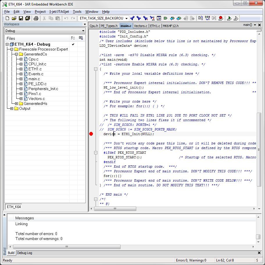

  /* THIS WILL FAIL IN ETH1 LINE 231 DUE TO PORT CLOCK NOT SET */
  /* The following two lines fixes it if uncommented */
//  /* SIM_SCGC5: PORTB=1 */
//  SIM_SCGC5 |= SIM_SCGC5_PORTB_MASK;
  device = ETH1_Init(NULL);
16815_16815.jpgBuild.jpg16816_16816.jpgDebuggerAtError.jpg16817_16817.jpgDebuggerAtInstructionCausingError.jpg

I have reproduced the error - there is missing initialization of port clock gate in the Ethernet component. Thank you for reporting this error. It will be fixed in the next release of Processor Expert (update).
You can use the code (you have stated above) in the Ethernet Init() fuction as a workaroud. When you modify the Init() function it is receomended to freze the generated code of the component in the Processor Expert (open the context menu of the Ethernet component in Processor Expert project and select Code Generation - > Don't Write Generated Component Modules).
