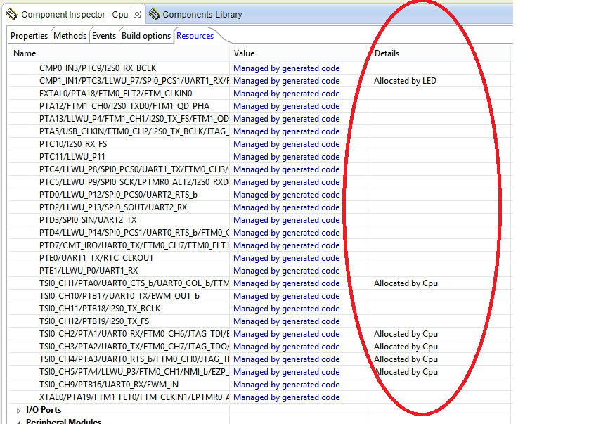

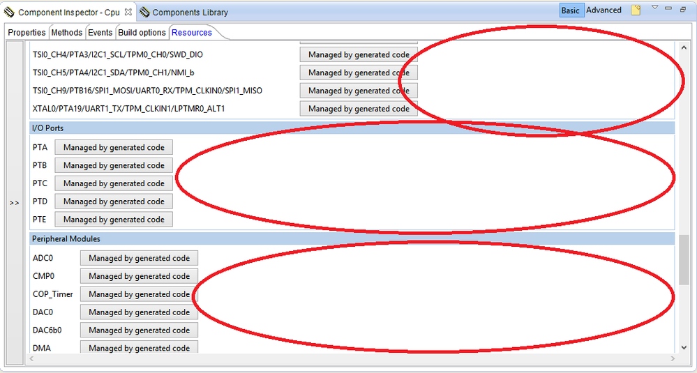

In the PE 10.4 (which I have access to via KDS 1.1.1) I cannot find a means of seeing the "details" in the Resources view of the CPU component:
In the v10.3 (available in CW 10.6) I can see these details in a third column as can be seen in the figure below:
Is this a change in the design and this information is now presented in another place?

Hello Cesar:
It seems that the new Tabs view is missing those details. But you can disable the Tabs_view and go back to classic, like this:

cesarrabak
Hi Jorge Gonzalez!
Yep! There it is!
Thank you very much!
