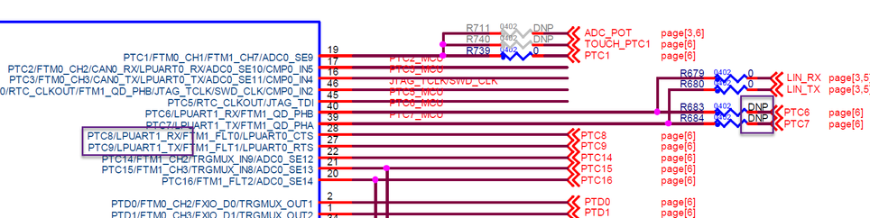

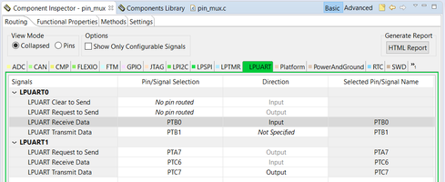

For LPUART1 I want to use pins PTC7 and  PTC6 as LPUART1_TX and LPUART1_RX, respectively, as marked in documentation. I'm unable to receive or send data through it, so I think is not well configured.
I used as a based the example lpuart_echo_s32k116, and I'm using Processor expert to configure my ports.

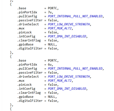

Generated code on pin_mux.c :
I also created a new component for lpuart2:

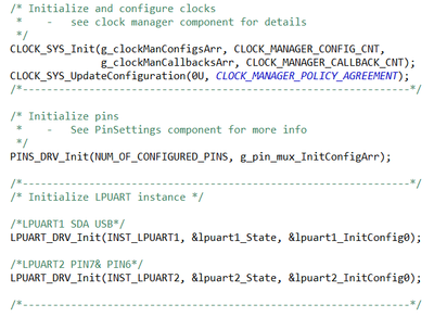

This is my initialization on my .c file:
With this simple code it gets stucked on LPUART_DRV_GetTransmitStatus function.

But the pins that you use are not connected to the PTC6, PTC7 headers but to the LIN transceiver instead.
You can try with PTC8, PTC9.
