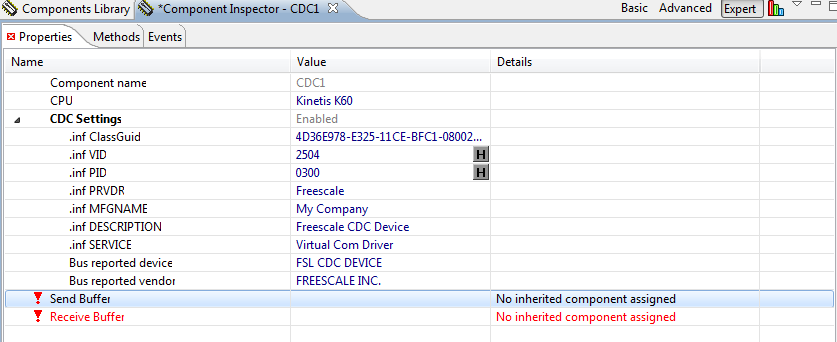

Hi Erich,
But when I import the USB component and try to set the send buffer and recive buffer for CDC, it shows "No inherited component assigned"
Thanks.
10,020 Views
BlackNight
You need to select a Rx and Tx RingBuffer (can you do a selection)?
Otherwise: This means that you have not all components loaded/imported. It looks like you have no ring buffer component installed.
Have you installed both *.PEupd files from
mcuoneclipse/PEupd at master · ErichStyger/mcuoneclipse · GitHub
See Processor Expert Component *.PEupd Files on GitHub | MCU on Eclipse

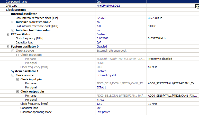

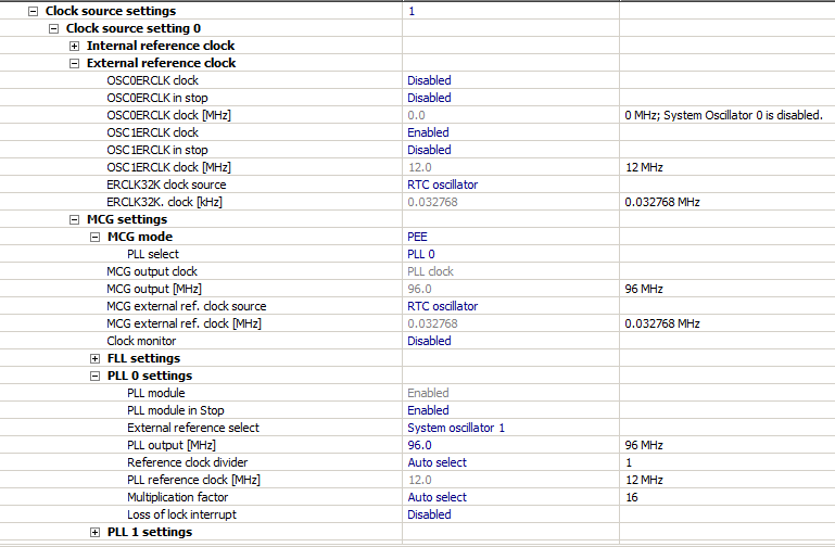

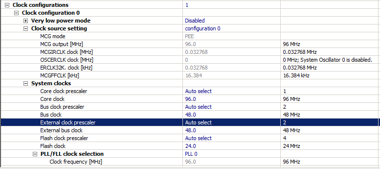

Hi Erich,
Thank you. I successfully made it work on the TWR-K60F120 board following Processor Expert Component *.PEupd Files on GitHub | MCU on Eclipse.
I made a mistake in the clock configuration part after I change it to 12Mhz, then it works.
Now I try to move it to my target board on which there is no 50Mhz external clock. It just has a RTC crystal and 12Mhz crystal.
I configured the clock settings as below.
After that, I generate the new code, but when I step to
MCG_C1 = (MCG_C1_CLKS(0x02) | MCG_C1_FRDIV(0x00) | MCG_C1_IRCLKEN_MASK);
it shows me
Do you have any ideas about this?
Thank you.
-Daniel

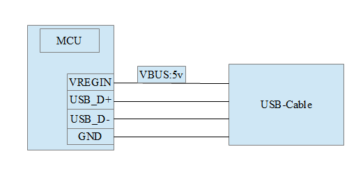

danielchai
Senior Contributor I
Hi Derek,
When I do a POR, it does not show up in my COM port. Then I am not sure if our board hardware's problem or my configuration's problem.
One more thing is that, on our board, we don't have the USB-OTG chip.
Then the connection is just as shown below.
I measured the VREGIN is 5v, but USB_D+ and USB_D- are all about 50mV.
I read that when it is plugged into the PC, the USB_D+ should be pull high.
Is there something wrong with this connection?
Thank you.
10,020 Views
