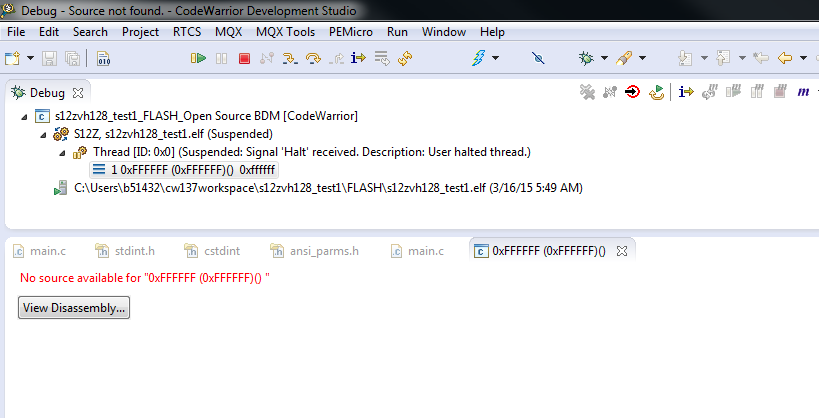

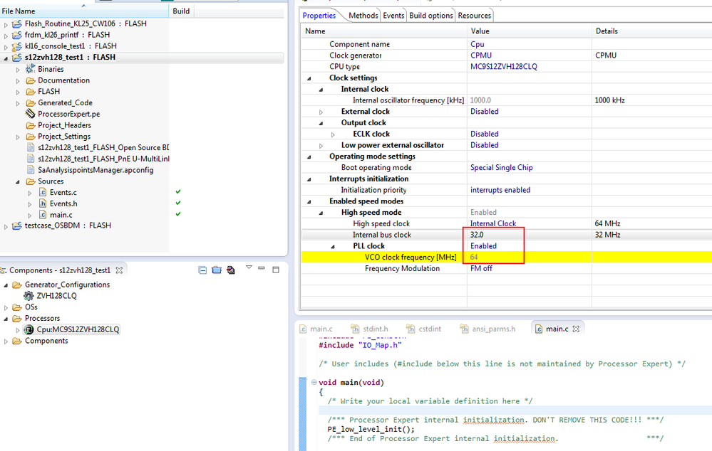

I configure the Bus clock 32 MHZ, use internal clock ,  S12ZVH128 chips. CW 10.6 -PE
There is no error when build , while ,when debug, it show this :
Where is wrong ?

I recieved feedback from P&E.
See below:
OSBDM interface supports run control debug with devices operating at bus frequencies between 500khz and 24Mhz.
Hence, it will not be able to support talking to a device operating at 30Mhz bus frequency.
For debugging device operating at higher bus frequency rates, we recommend looking into using P&E's USB Universal Multilink hardware interface:
          http://www.pemicro.com/products/product_viewDetails.cfm?product_id=15320137&menu_id=details
Pascal

The crash of the application can be caused by many reasons (debugger settings, error in a driver/application code, target board/silicon connection and so on).  Have you analyzed the application which part of the code (line) cause the error?
What target board and silicon are you using?
Could you send me the application for analysis, please?

Hi Marek,
I've reproduced the problem on my side too with a S12ZVML-MINIBRD.
I've reported the issue to P&E.
Attached a video showing the problem.
