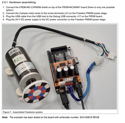

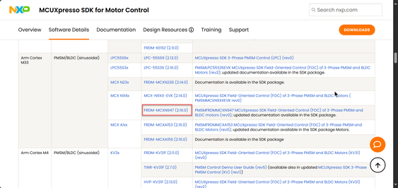

The MCXA153 sounds good, but I could better recommend the MCXN947, since it includes an NPU that you could use for your AI. Additionally, there is already an application note that uses the FRDM-MC-LVPSMS on this page.
The SDK version where the example is found is mentioned on this same page, as shown in the next image:
Also, if you experience any issue, does not hesitate to let me know.

So, the idea would be to get the FRDM-MCXN947 and still with the frdm-mc-lvpmsm and the frdm-mc-lvmtb ?
Yes, the MCXN947 includes an NPU, which can enhance the performance of your AI applications.
Additionally, the FRDM-MC-LVPMMSM board is compatible with the MCXN947 and provides a 3-phase bridge inverter for motor control applications.
However, you will need to create and set up the AI models yourself, based on what your project needs.

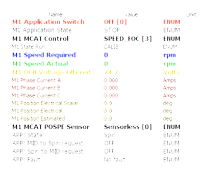

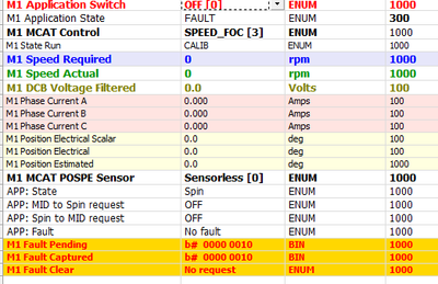

im currently trying to use the setuup you recommended me but im getting some troubles to get the app to work . When im doing the debug on MCUxpresso IDE i receive this message, should this be a problem?
then when im trying to set the on on the application switch it doesnt let me do it, stays on off
on the video appears like this
do you have any idea how to solve this problem?
