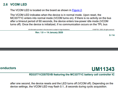

Now its working fine thank you so much...during sleep mode What about VCOM  LED status? i put cyclic timer 8sec. LED Continuous glowing,after went to sleep mode also.

JozefKozon
Hi Prabu,
please share the EVB number you are using. I have checked RD33771CDSTEVB user guide, and the VCOM LED should be on when the the MC33771C is in Normal mode. Not stated VCOM LED behavior in Sleep mode.

JozefKozon
Dear Prabu,
according to the UM11402 the VCOM LED indicates normal mode or low power mode. According to the MC33771C datasheet, the low power state is different, than Sleep mode. It looks your board works correctly.
