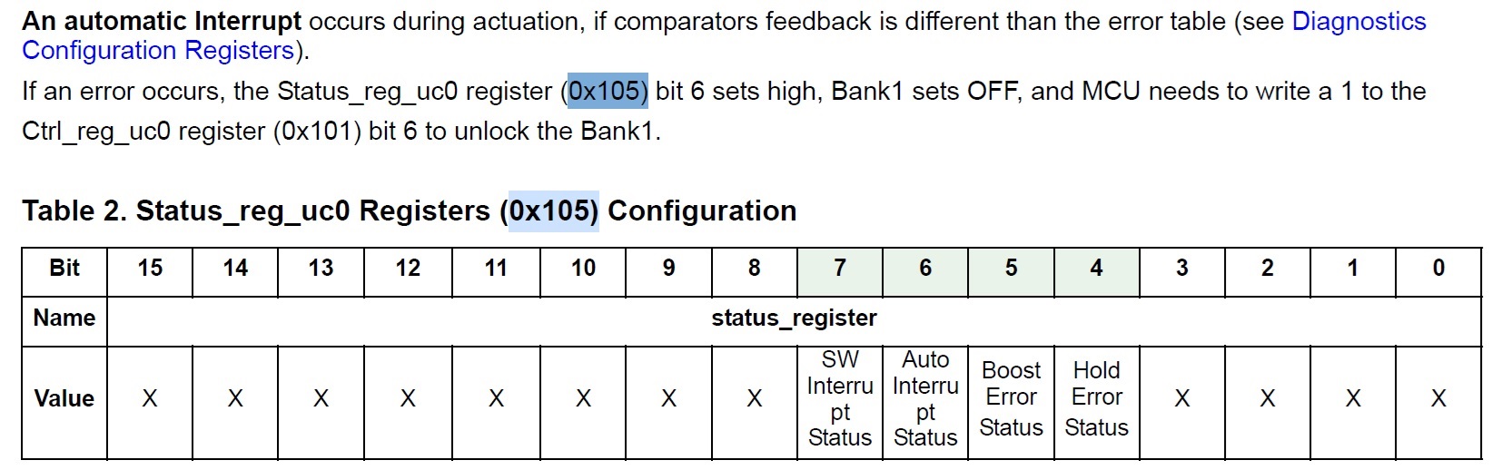

As you pointed the section 6.17.6.1.6 in the MC33816 datasheet, the Status_reg_uc0 (0x105) is read only register. I know that this is MCU's perspective.
Actually, I can set (written) bits of the Status_reg_uc0 register (0x105) using MC33816 microcode instruction e.g. "stsrb high b0".

DESCRIPTION
1. how to handle conditions to set bit 0 for INJ1 failure and bit 1 for INJ2 failure?
        a. Does MC33816 automatically check the fault condition if source HS1 shorted to GND? if then which bits of the status register(0x105) match to each fault cases. -> This is really depending on how teh microcode is written by customer. In our app note example if a short to GND is detected before injector turn on meaning during idle mode then we set this bit (bit7) in status register
        Or
       b. Do I need to set the status bit per fault cases? if then how can I do check the condition prior to setting the status bit high.
-> You then need to clear this bit by writing a 1 in control register
    2. As far as I learned from the mc33816 datasheet, the bit (let say bit0) of the status register (0x105) should be cleared once matching bit (bit0) of control register (0x101) written high in MCU application. -> Correct for the code example we gave
        I verified that bit6 (Auto interrupt Status) of the register 0x105 is cleared once bit6 (Auto interrupt Unlock) of the register 0x101 is written high. -> COrrect
-> This really depend on microcode implementation in our example. To resume operation we lock operation in one of those three loops
Meaning that you must write control register (100 or 101) to 1 to unlock operation.

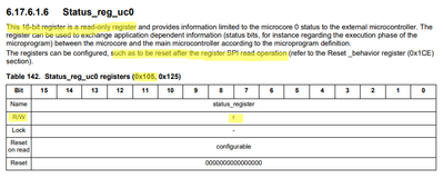

1. how to set bits of the status register (0x105)?
[A] Please refer to the section 6.17.6.1.6 in the MC33816 datasheet. The Status_reg_uc0 (0x105) is read only register. You cannot write to this register. You can only reset it.
2. how to handle conditions to set bit 0 for INJ1 failure and bit 1 for INJ2 failure?
[A] Could you please elaborate which failures you mean? I couldn't find description of "bit 0 for INJ1 failure and bit 1 for INJ2 failure" in the datasheet.

I managed to handle the interrupt that I could set bit 0 of the Status Register in the microcode and then read the error in ProcessAutomaticInterrupts() of my application.
Now I would like to know more detail about the Status Register (0x105).
According to the the docs. (MC33816 Data sheet and AN4954 Application Node), it informs of bit4 ~ bit7 e.g. HoldErrorStatus (bit4), BoostErrorStatus (bit5), and so on.
Can you please let me know what the others bits for ?
It is hard for me to get the bits info of (bit00 ~ bit03) and (bit8 ~ bit 15).
