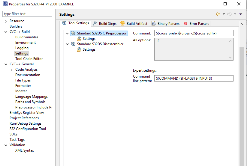

Thanks for replying, i am getting this: Program "gcc" not found in PATH S32K144_PT2001_EXAMPLE [Discovery Options] page in project properties C/C++ Problem
Eitan
4,957 Views
jiri_kral
Please use build variables in Project properties - linker settings. Instead gcc put ${cross_prefix}${cross_c}${cross_suffix} :

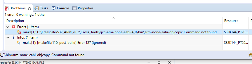

Dear Jiri, Thank you vary much, this version took me further, but i am still getting an error after the build, See below

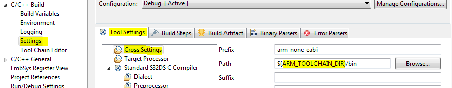

based on information in Problem view, I assume that this example has older setting for the path variable and it is pointing to wrong directory where compiler supposed to be.
Could you please check the setting for the Path, it should be ${ARM_TOOLCHAIN_DIR}/bin like on screenshot below:

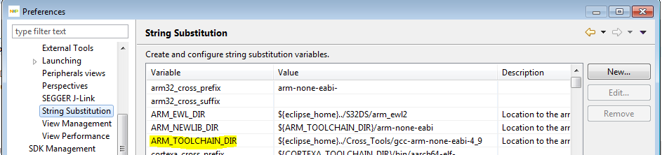

if PATH setup properly, please check what value ARM_TOOLCHAIN_DIR variable has (go to Window->Preferences->Run/Debug->String Substitution)
4,958 Views
eitan
Hi Irina, Thanks for your answer and information, I have checked, the ARM_TOOLCHAIN_DIR have the following value: ${eclipse_home}../Cross_Tools/gcc-arm-none-eabi-4_9

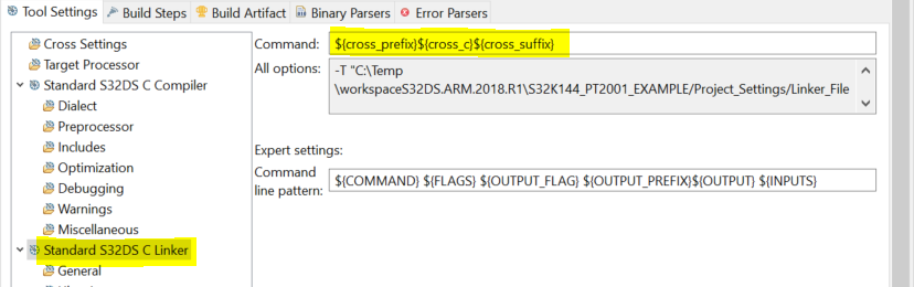

b13310
Hello Eitan,
checked the example project, you might need to update the following settings for the Linker - should be ${cross_prefix}${cross_c}${cross_suffix} like below:
and as well I found out that Post build settings has hardcoded path to build tools, need to be updated:
(or you can use functionality of Create flash image to generate S-record output - using this checkbox and then configuring output type)
