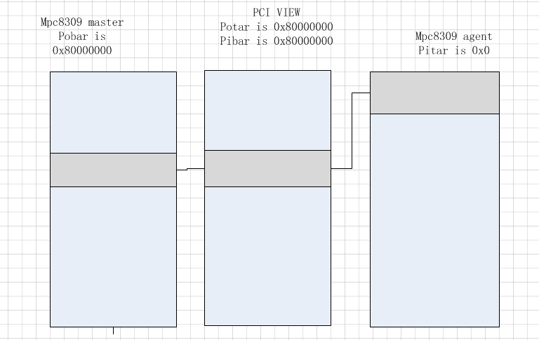

hello,
 I use two mpc8309 ,one as master pci device,another as agent pci device, all run linux OS, my board is likely mpc8309-SOM board. i configure master pci device's outbound like this under uboot(uboot version is u-boot-2010.06 ):
#define CONFIG_SYS_PCI1_MEM_BASE 0x80000000
#define CONFIG_SYS_PCI1_MEM_PHYS CONFIG_SYS_PCI1_MEM_BASE
#define CONFIG_SYS_PCI1_MEM_SIZE 0x10000000 /* 256M */

configure agent pci device's inbound like this under uboot(uboot version is u-boot-2010.06 ):

master device can write and read 0x80000000 ~0x80100000, agent can read and write 0x0~0x100000.
i think mapping like this
but i don't want to use pitar is 0x0 ,i want use pitar is 0x80000000, i configure pci_ctrl->pitar1 = 0x80000000, pci don't working ,please give me some advices.
Thanks.
