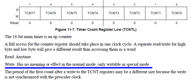

Hello shiweili,
I can’t see the figures in the post.
What does it mean that it does not work properly?
The MCU is in Special Mode during debugging but in Normal Mode after POR.
Some registers have a different read/write specification in the modes.
For example:
Could you share a test project?
You can refer to this example:
S12ZVL-TIM-FrequencyMeasurement-V1_0-CW106-TIC-EXAMPLE
