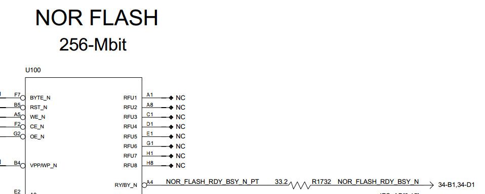

As our custom T1042 board, IFC controller connect a 32MB nor flash(16-bit width) by CS0 and connect a 8-bit CPLD by CS2. CS0 was configured with NOR mode through MSEL bit of OR. and CS2 was configured with GPCM mode through MSEL bit of OR. There's no problem if access each at different time, but if accessing the CPLD, we do erase/write to nor flash, it will make the read/write CPLD not reliable, all registers read from CPLD turn-ed to be all zeros. That's very strange. once this problem happened, the cs signal of CS2 for CPLD seems to be abort-ed by IFC controller. we dump-ed the 0xFFE125800 register, it's value turn-ed to be 0x00400000, that means the transaction to CPLD was abort-ed during erasing/writing to NOR flash.
But If I turn the CS2 MSEL into NOR mode. the word turn to be peace. But I can't explain the problem, there may be some potential design bug for IFC controller side.

Background is quite simple, in case of GPCM RB0 signal acts as IFCTA_B, if asserted (like in your case) it aborts transaction to CPLD. When you re-configure CPLD to NOR FLASH machine, there is no such a problem/effect.
Yes, you can use a workaround as you described if HW changes are unwanted. Note however, schematics is not correct anyway, I do not see a pull-up resistor on RB0 signal, or it is placed somewhere outside of visible area. Typically RY/BY# signal of NOR flash devices is an open-drain output, i.e. it can pull down the signal, but pulling up should be provided by an external pull-up resistor.

What is the connection of flash's RY/BY# signal in your design?

RY/BY of NOR FLASH connect-ed to IFC's IFC_RB0_N
CPU IFC side's RB0 signal
General other signal of IFC (CPU side)
Do you need more signal from the design?

I believe the problem is really due to RY/BY# signal connection. It stops IFC normal operations when asserted. In fact the NOR flash does not need to report "busy" state to the controller, so you need 1) to remove flash's RY/BY# to CPU's RB0 connection and 2) to pull up unused RB0 signal. This will solve your issue.

One more question, if change the CPLD into NOR mode, since there's no RB signal to make the IFC controller know who is busy? Will it impact the NOR flash's erase/write during read/write CPLD at the same time? since as to GPCM, RB will be asserted to abort CPLD operation. IFC make sure only nor flash operation ongoing.

I do not clearly understand your question. On the one hand the controller can not know "who" asserted busy signal (if several CS's share the same RBn). On the other hand the controller does not need this information. I already wrote, the NOR flash does not need to report "busy" state to the controller via RB signal, so this connection can be removed at all without any problem.
I also believe your CPLD is not connected to RB0 signal, so no problem here.
Probably your question is answered? let me know if not.

Yes, you're right, from NOR flash datasheet, need a pull-up in advice
