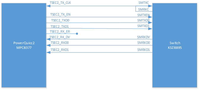

We're currently triying to communicate using RMII bus with a Micrel Ethernet Switch (KZS8895RQ).
We also using MDC / MDIO link to configure it.
The MDC / MDIO link works well. We can see when a connection is established on a port of the switch.
We have plugged the RMII of our MPC8377 to the SW5 MAC of the Switch.
We have configured the MAC of the Switch to work in "PHY Mode" to permit to communicate with the MAC of our MPC8377.
We have successfully configured the MPC8377 to work in RMII mode and not in RGMII (default value)
We have made this connection:
The clock is generated at 50MHz by the Switch.
We are in Linux 2.6.38  Environment with an adapted generic driver from micrel.c file.
We are using dts to configure our switch :

When we make ping from the linux board to a PC connected to the switch we can see data on the RMII bus with a scope but never on the Ethernet
When we make a ping from the PC to the board, wa can see RMII data but linux never see them.
When we plug two computer onto the switch they communicate successfully (so the ethernet transformer are Ok)
Why ?
Any idea ? or question to clarify my request ?

Hi Nicolas
>  local-mac-address = [ 12 23 45 56 67 01 ];
Please don't do this. This may or may not be the source
of the problem but please only use a valid mac address.
If you don't know the mac address of your phy you can
generate a temporary (fake) one with tools/gen_eth_addr
from mainline uboot sources (e.g. here is one I
generated now for you : 1a:2b:6a:60:89:02)
Hope this helps
Sinan Akman
1,628 Views
hilairenicolas
ok thank you, I will use this mac address But effectively, it doesn't correct the problem. :smileysad:
