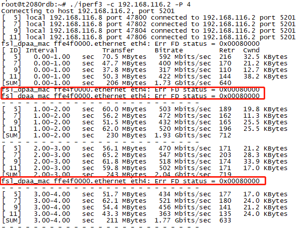

@yipingwang   hi, I tried add "fixed-link = <0 1 10000 0 0>;" but it's useless.
And recent days, I tried linux 4.9, 4.19, and  5.4,  in https://source.codeaurora.org/external/qoriq/qoriq-components/linux , my board's 10G eth (ethernet@f0000) also not work , it only receive bytes when PC ping it's port,  but not send any bytes out.   Addtion, any version of linux above (4.9, 4.19, and  5.4) I build , my 1G eth (ethernet@e4000)  baudwidth performs good (up to 1Gbps).
And especially that when I build QorIQ sdk 2.0's linux (v4.1), my board's 1G eth (ethernet@e4000) and 10G eth (ethernet@f0000) could work, but both baudwidth perform very badly.
6,651 Views
Rainight
I  add a line "q->enqueue = NULL;"  in function __dev_queue_xmit    (net/core/dev.c)(linux 5.4), my 10G eth (ethernet@f0000) could work,  but baudwidth only 2Gbps.
    q->enqueue = NULL;
    if (q->enqueue) {
		rc = __dev_xmit_skb(skb, q, dev, txq);
		goto out;
and report error like this:
fsl_dpaa_mac ffe4f0000.ethernet eth4: Err FD status = 0x00080000
6,639 Views
