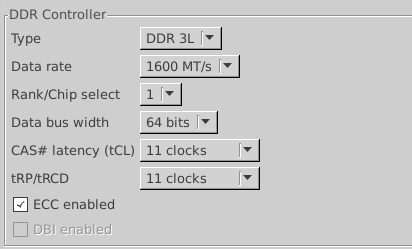

Hello, I'm trying to configure DDR3l on the T1042. Attach pdf for DDR3l - AS4C512M16D3L. (4 DDR3l + 1 DDR3l for ECC).
To create a .tcl script I use QorlQ Configuration Project.
1) Question - DRAM configuration  - 2GB: 512 x 4?
2) Question - parametr DDR3l controller are true?
3) Question (the most difficult to understand) - length of lines ? This is the length of the line from CLK from DQS ?
Developers of our site provided me with data:
DQS0 58.793/58.399
DQS1 60.073/60.308
DQS2 50.51/50.213
DQS3 47.891/48.06
DQS4 30.003/29.952
DQS5 31.789/32.076
DQS6 28.033/27.944
DQS7 28.345/29.347
DQS8 44.222/43.724
CLK 47.05 + 14.8 + 15.03 + 15.96 + 16.08
I entered: 58 60 50 48 30 31 28 29 44 and get .tcl script^

Farther attach > reset > source %scritp%. As can be seen from the code ddr mapped 0x0 . I read 0x0 ( mem 0x0) and see error:
Error reading memory
 [CCS last error: Scan timeout]

yipingwang
Hello megaloldean megaloldean ,
I explain something about how to use DDRv tool.
If there is SPD on the target board, the user can use reading from SPD method to create and initial QCVS DDR project. If there is no SPD, the user needs to create a default QCVS project, then fill DDR related properties according to DDR data sheet to generate the initial DDR controller configuration parameters.
Then use DDRv tool to connect to the target board to do optimization and validation, the user needs to complete "Centering the clock", "Read ODT and driver" and "Write ODT and dirver" validations to get the final optimized DDR controller configuration parameters.
For detailed usage, please refer to https://emea01.safelinks.protection.outlook.com/?url=https%3A%2F%2Fwww.nxp.com%2Fdocs%2Fen%2Fuser-gu...
After validation with DDRv in QCVS project, please regenerate DDR configuration script from Project->Generate Processor Expert code, then use DDR controller configuration parameters in script ddrCtrl_1.py in u-boot or DDR initialization file.
The customer could refer to this document https://emea01.safelinks.protection.outlook.com/?url=https%3A%2F%2Fcommunity.nxp.com%2Fdocs%2FDOC-33....

megaloldeanmega
Thank you Yiping Wang.
I ran into the problem with validation. I use codewarrior tap (usb) and when validating the validation, all cells indicate an error. Error in each cell - D_INIT was not cleared by hardware!
I noticed that in CCS always: CCSAPI connection #1 from %my_machine_name% closed
How can I correct these errors and pass validation?
4,552 Views
EmbEng
megaloldeanmegaloldean‌ were you able to solve this problem? We are stuck at same point.
