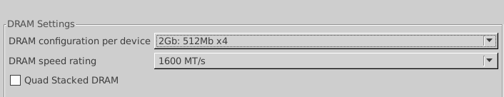

Hello, I'm trying to configure DDR3l on the T1042. Attach pdf for DDR3l - AS4C512M16D3L. (4 DDR3l + 1 DDR3l for ECC).
To create a .tcl script I use QorlQ Configuration Project.
1) Question - DRAM configuration  - 2GB: 512 x 4?
2) Question - parametr DDR3l controller are true?
3) Question (the most difficult to understand) - length of lines ? This is the length of the line from CLK from DQS ?
Developers of our site provided me with data:
DQS0 58.793/58.399
DQS1 60.073/60.308
DQS2 50.51/50.213
DQS3 47.891/48.06
DQS4 30.003/29.952
DQS5 31.789/32.076
DQS6 28.033/27.944
DQS7 28.345/29.347
DQS8 44.222/43.724
CLK 47.05 + 14.8 + 15.03 + 15.96 + 16.08
I entered: 58 60 50 48 30 31 28 29 44 and get .tcl script^

Farther attach > reset > source %scritp%. As can be seen from the code ddr mapped 0x0 . I read 0x0 ( mem 0x0) and see error:
Error reading memory
 [CCS last error: Scan timeout]
