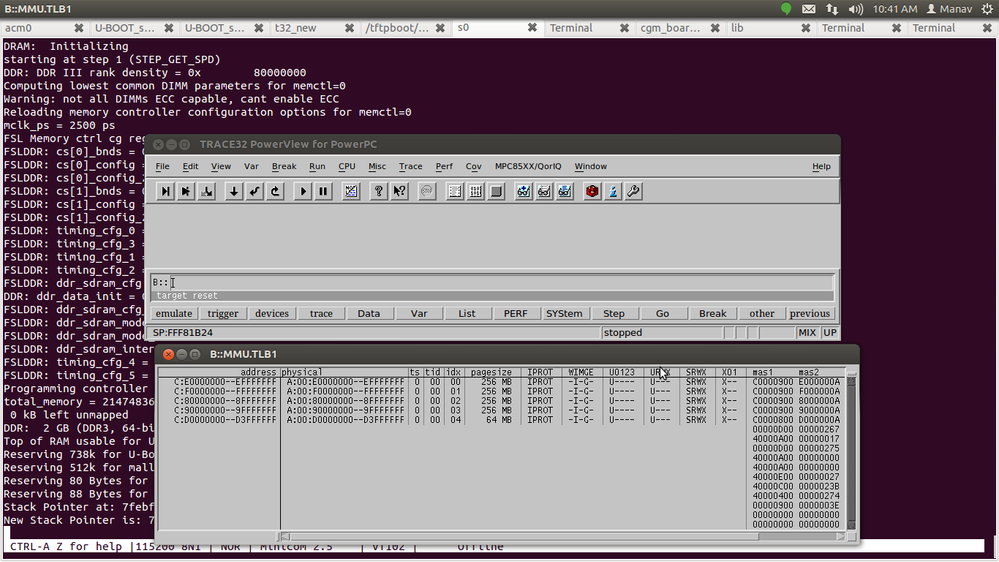

The Following image shows the dump of tlb after crash !!
Can you help me understand what is the role of this tlb entry in tlb.c. Additionally I didn't quite understand the 'epn' and 'rpn' argumnets from description in "E500_core_rm.pdf". Can you explain that a bit.
Thanks in advance.

I knew that it was a TLB miss because of "vector=d00", which corresponds to "STD_EXCEPTION(0x0d00, DataTLBError, UnknownException)" in arch/powerpc/cpu/mpc85xx/start.S.
Your problem is that you're using the same ESEL (entry select) for both entries, so the second entry will overwrite the first, and you will have no mapping for the first half of flash.  You need to pick an unused ESEL for the second entry.

Hi Scott,
Great Information @Scott. I think I tried a different esel too. I have rechecked by using esel as 1 in the second TLB entry , the one for the higher flash.
This is what I have used:
SET_TLB_ENTRY(1/*_tlb*/, CONFIG_SYS_FLASH_BASE/*epn*/, CONFIG_SYS_FLASH_BASE/*rpn*/,
                      MAS3_SX|MAS3_SW|MAS3_SR/*perms*/, MAS2_I|MAS2_G/*wimge*/,
                      0/*ts*/, 0/*esel*/, BOOKE_PAGESZ_256M/*_sz*/, 1/*iprot*/),
    SET_TLB_ENTRY(1/*_tlb*/, CONFIG_SYS_FLASH_BASE2/*epn*/, CONFIG_SYS_FLASH_BASE2/*rpn*/,
                      0/*ts*/, 1/*esel*/, BOOKE_PAGESZ_256M/*_sz*/, 1/*iprot*/),
The error remained totally the same.

scottwood
Could you please paste it in case it's not 100% identical, and double check that you're running the modified code?  Also, that tlb.c can't be the whole file because it ends without closing the array.
Could you use a debugger to dump the TLB1 contents after the crash?

And the Snapshot of TLB1 from lauterback debugger after crash occurs is attached.dump.png
6,795 次查看
scottwood
The TLB entry for CONFIG_SYS_PCIE1_MEM_VIRT is using ESEL1 and overwriting the entry that maps flash (sorry for not noticing this in what you had posted before).  You swapped "FLASH_BASE" with "FLASH_BASE2" relative to the code snippet you posted earlier, which is why the faulting address is still 0xe0000000 and not somewhere in the second half.
6,795 次查看
manavdeep
Hi Scott,
Yeah I noticed it too later !! I corrected It.
Now I am gonna show you two configurations. This should really narrow down. Please hold on a little more with me.

#define CONFIG_BOOKE 1 /* BOOKE */
#define CONFIG_E500 1 /* BOOKE e500 family */
#define CONFIG_MPC85xx 1 /* MPC8540/60/55/41/48/68 */
#define CONFIG_MPC8569 1 /* MPC8569 specific */
#define CONFIG_MPC8569MDS 1 /* MPC8569MDS board specific */
#define CONFIG_POST 1
#define CONFIG_SYS_POST_MEMORY 1
#define CONFIG_FSL_ELBC 1 /* Has Enhance localbus controller */
#define CONFIG_PCI 1 /* Disable PCI/PCIE */
#define CONFIG_PCIE1 1 /* PCIE controller */
#define CONFIG_FSL_PCI_INIT 1 /* use common fsl pci init code */
#define CONFIG_FSL_PCIE_RESET 1 /* need PCIe reset errata */
#define CONFIG_SYS_PCI_64BIT 1 /* enable 64-bit PCI resources */
#define CONFIG_QE /* Enable QE */
#define CONFIG_ENV_OVERWRITE
#define CONFIG_FSL_LAW 1 /* Use common FSL init code */
#ifndef __ASSEMBLY__
extern unsigned long get_clock_freq(void);
#endif
/* Replace a call to get_clock_freq (after it is implemented)*/
#define CONFIG_SYS_CLK_FREQ 66666666
#define CONFIG_DDR_CLK_FREQ CONFIG_SYS_CLK_FREQ
/*#define CONFIG_DDR_CLK_FREQ     40000000 */
/*MURMU
#define CONFIG_PQ_MDS_PIB
#ifdef CONFIG_MK_ATM
#define CONFIG_PQ_MDS_PIB_ATM
#endif
#ifdef CONFIG_MK_NAND
#define CONFIG_NAND_U_BOOT 1
#define CONFIG_RAMBOOT_NAND 1
#define CONFIG_RAMBOOT_TEXT_BASE 0xf8f82000
#endif
#ifdef CONFIG_MK_DDR2
#define CONFIG_FSL_DDR2
#endif
/* MT8JSF12864HY */
#ifdef CONFIG_MK_DDR3HY
#if defined(CONFIG_MK_DDR2)
#error "Err: enabled two kinds of DDR!"
#endif
#define CONFIG_FSL_DDR3
#define CONFIG_FSL_DDR3_RTT_WR 2
#endif
/* MT8JSF12864HZ */
#ifdef CONFIG_MK_DDR3HZ
#if defined(CONFIG_MK_DDR2) || defined(CONFIG_MK_DDR3HY)
#error "Err: enabled two/three kinds of DDR!"
#endif
#define CONFIG_FSL_DDR3_RTT_WR 0
#endif
#if !defined(CONFIG_MK_DDR2) && !defined(CONFIG_MK_DDR3HY) && \
  !defined(CONFIG_MK_DDR3HZ)
#error "Err: none of DDR is specified!"
#error "     Must specify one kind of DDR(DDR2, DDR3HZ or DDR3HY)"
#endif
* These can be toggled for performance analysis, otherwise use default.
#define CONFIG_L2_CACHE /* toggle L2 cache */
#define CONFIG_BTB /* toggle branch predition */
* Only possible on E500 Version 2 or newer cores.
#define CONFIG_ENABLE_36BIT_PHYS
#define CONFIG_BOARD_EARLY_INIT_F /* Call board_pre_init */
#define CONFIG_MISC_INIT_R /* call misc_init_r()  */
#define CONFIG_HWCONFIG
#define CONFIG_SYS_MEMTEST_START 0x00200000 /* memtest works on */
#define CONFIG_SYS_MEMTEST_END 0x00400000
* Config the L2 Cache as L2 SRAM
#define CONFIG_SYS_INIT_L2_ADDR 0xf8f80000
#define CONFIG_SYS_INIT_L2_ADDR_PHYS CONFIG_SYS_INIT_L2_ADDR
#define CONFIG_SYS_L2_SIZE (512 << 10)
#define CONFIG_SYS_INIT_L2_END (CONFIG_SYS_INIT_L2_ADDR + CONFIG_SYS_L2_SIZE)
* Base addresses -- Note these are effective addresses where the
* actual resources get mapped (not physical addresses)
#define CONFIG_SYS_CCSRBAR 0xD0000000 /* relocated CCSRBAR */ // See board/freescale/mpc8569mds/law.c for memory map
#define CONFIG_SYS_CCSRBAR_PHYS CONFIG_SYS_CCSRBAR
  /* physical addr of CCSRBAR */
#define CONFIG_SYS_IMMR CONFIG_SYS_CCSRBAR
  /* PQII uses CONFIG_SYS_IMMR */
#if defined(CONFIG_RAMBOOT_NAND) && !defined(CONFIG_NAND_SPL)
#define CONFIG_SYS_CCSRBAR_DEFAULT CONFIG_SYS_CCSRBAR
#else
#define CONFIG_SYS_CCSRBAR_DEFAULT 0xff700000 /*CCSRBAR Default */
#endif
#define CONFIG_SYS_PCI1_ADDR           (CONFIG_SYS_CCSRBAR+0x8000)
#define CONFIG_SYS_PCIE1_ADDR          (CONFIG_SYS_CCSRBAR+0xa000)
/* DDR Setup */
#undef CONFIG_FSL_DDR_INTERACTIVE
#define CONFIG_SPD_EEPROM /* Use SPD EEPROM for DDR setup*/ /* Not using SPD EEPROM MURMU*/
#define CONFIG_DDR_SPD
#define CONFIG_DDR_DLL /* possible DLL fix needed */
#define CONFIG_ECC_INIT_VIA_DDRCONTROLLER /* DDR controller or DMA? */
#define CONFIG_MEM_INIT_VALUE 0xDeadBeef /*0xDeadBeef */
#define CONFIG_SYS_DDR_SDRAM_BASE 0x00000000
  /* DDR is system memory*/
#define CONFIG_SYS_SDRAM_BASE CONFIG_SYS_DDR_SDRAM_BASE
#define CONFIG_NUM_DDR_CONTROLLERS 1
#define CONFIG_DIMM_SLOTS_PER_CTLR 1
#define CONFIG_CHIP_SELECTS_PER_CTRL (2 * CONFIG_DIMM_SLOTS_PER_CTLR)
/* I2C addresses of SPD EEPROMs */
#define SPD_EEPROM_ADDRESS1    0x51    /* CTLR 0 DIMM 0 */ /*MURMU Since MPC8569 has dual I2C Controller, these are the controller addresses */
#define SPD_EEPROM_ADDRESS2    0x52    /* CTLR 1 DIMM 0 */
/* These are used when DDR doesn't use SPD.  */
#define CONFIG_SYS_SDRAM_SIZE           2048 /* DDR is 2048MB */
#define CONFIG_SYS_DDR_CS0_BNDS         0x0000007F      /* for 2048MB */
#define CONFIG_SYS_DDR_CS0_CONFIG       0x80014302      /* 15 rows, 10 cols, 3 Bank addr */
#define CONFIG_SYS_DDR_TIMING_3         0x00020000      /*0x00020000 */
#define CONFIG_SYS_DDR_TIMING_0         0x00330004
#define CONFIG_SYS_DDR_TIMING_1         0x6F6F4644      /*0x6F6B4644*/
#define CONFIG_SYS_DDR_TIMING_2         0x002888D0
#define CONFIG_SYS_DDR_SDRAM_CFG 0x47000000
#define CONFIG_SYS_DDR_SDRAM_CFG_2 0x04401040
#define CONFIG_SYS_DDR_SDRAM_MODE 0x40401521
#define CONFIG_SYS_DDR_SDRAM_MODE_2 0x8000C000
#define CONFIG_SYS_DDR_SDRAM_INTERVAL 0x03E00000
#define CONFIG_SYS_DDR_DATA_INIT        0xdeadbeef    /*deadbeef*/
#define CONFIG_SYS_DDR_SDRAM_CLK_CNTL 0x01000000
#define CONFIG_SYS_DDR_TIMING_4         0x00220001
#define CONFIG_SYS_DDR_TIMING_5         0x03402400
#define CONFIG_SYS_DDR_ZQ_CNTL 0x89080600
#define CONFIG_SYS_DDR_WRLVL_CNTL 0x0655A604
#define CONFIG_SYS_DDR_CDR_1 0x80040000
#define CONFIG_SYS_DDR_CDR_2 0x00000000
#define CONFIG_SYS_DDR_OCD_CTRL         0x00000000
#define CONFIG_SYS_DDR_OCD_STATUS       0x00000000
#define CONFIG_SYS_DDR_CONTROL          0xc7000000      /* Type = DDR3 */
#define CONFIG_SYS_DDR_CONTROL2         0x24400000
#define CONFIG_SYS_DDR_ERR_INT_EN       0x0000000d
#define CONFIG_SYS_DDR_ERR_DIS          0x00000000
#define CONFIG_SYS_DDR_SBE              0x00010000
#undef CONFIG_CLOCKS_IN_MHZ
* Local Bus Definitions
/*addition MURMU */
#define CONFIG_SYS_FLASH_BASE          0xF0000000 //CS0     /* Second flash bank of 256MB */
#define CONFIG_SYS_FLASH_BASE_PHYS      CONFIG_SYS_FLASH_BASE
#define CONFIG_SYS_CPLD_BASE 0xD0120000 /* Base addres for CPLD, FPGA, RTC etc devices */
/*Chip select 0 - Flash 2*/
#define CONFIG_FLASH_BR_PRELIM 0xF0001011 // 0xF0001011
#define CONFIG_FLASH_OR_PRELIM 0xF0006FF7
* Chip Select 4 - CPLD */
#define CONFIG_SYS_BR4_PRELIM 0xD0120811
#define CONFIG_SYS_OR4_PRELIM 0xFFFFEFF7
#define CONFIG_SYS_FLASH_QUIET_TEST
#define CONFIG_FLASH_SHOW_PROGRESS 45  /* count down from 45/5: 9..1 */
#define CONFIG_SYS_MAX_FLASH_BANKS 1 // changed from 2 /* number of banks */
#define CONFIG_SYS_MAX_FLASH_SECT 2048 // Changed from 1024 /* sectors per device */
#undef CONFIG_SYS_FLASH_CHECKSUM
#define CONFIG_SYS_FLASH_ERASE_TOUT 60000 /* Flash Erase Timeout (ms) */
#define CONFIG_SYS_FLASH_WRITE_TOUT 500 /* Flash Write Timeout (ms) */
#define CONFIG_SYS_MONITOR_BASE TEXT_BASE /* start of monitor */
#if defined(CONFIG_SYS_SPL) || defined(CONFIG_RAMBOOT_NAND)
#define CONFIG_SYS_RAMBOOT
#else
#undef CONFIG_SYS_RAMBOOT
#endif
#define CONFIG_FLASH_CFI_DRIVER
#define CONFIG_SYS_FLASH_CFI
#define CONFIG_SYS_FLASH_EMPTY_INFO
/*MURMU there is no nand device
Chip select 3 - NAND
#ifndef CONFIG_NAND_SPL
#define CONFIG_SYS_NAND_BASE 0xFC000000
#else
#define CONFIG_SYS_NAND_BASE 0xFFF00000
#endif
/* NAND boot: 4K NAND loader config  */
#define CONFIG_SYS_NAND_SPL_SIZE 0x1000
#define CONFIG_SYS_NAND_U_BOOT_SIZE ((512 << 10) - 0x2000)
#define CONFIG_SYS_NAND_U_BOOT_DST (CONFIG_SYS_INIT_L2_ADDR)
#define CONFIG_SYS_NAND_U_BOOT_START \
  (CONFIG_SYS_INIT_L2_ADDR + CONFIG_SYS_NAND_SPL_SIZE)
#define CONFIG_SYS_NAND_U_BOOT_OFFS (0)
#define CONFIG_SYS_NAND_U_BOOT_RELOC (CONFIG_SYS_INIT_L2_END - 0x2000)
#define CONFIG_SYS_NAND_U_BOOT_RELOC_SP ((CONFIG_SYS_INIT_L2_END - 1) & ~0xF)
#define CONFIG_SYS_NAND_BASE_PHYS CONFIG_SYS_NAND_BASE
#define CONFIG_SYS_NAND_BASE_LIST { CONFIG_SYS_NAND_BASE, }
#define CONFIG_SYS_MAX_NAND_DEVICE 1
#define CONFIG_MTD_NAND_VERIFY_WRITE 1
#define CONFIG_CMD_NAND 1
#define CONFIG_NAND_FSL_ELBC 1
#define CONFIG_SYS_NAND_BLOCK_SIZE (128 * 1024)
#define CONFIG_NAND_BR_PRELIM (CONFIG_SYS_NAND_BASE_PHYS \
  | (2<<BR_DECC_SHIFT)   \
  | BR_PS_8       \
  | BR_MS_FCM       \
  | BR_V)
#define CONFIG_NAND_OR_PRELIM (0xFFFC0000       \
  | OR_FCM_CSCT \
  | OR_FCM_CST \
  | OR_FCM_CHT \
  | OR_FCM_SCY_1 \
  | OR_FCM_TRLX \
  | OR_FCM_EHTR)
#ifdef CONFIG_RAMBOOT_NAND
#define CONFIG_SYS_BR0_PRELIM CONFIG_NAND_BR_PRELIM /* NAND Base Address */
#define CONFIG_SYS_OR0_PRELIM CONFIG_NAND_OR_PRELIM /* NAND Options */
#define CONFIG_SYS_BR3_PRELIM CONFIG_FLASH_BR_PRELIM /* NOR Base Address */
#define CONFIG_SYS_OR3_PRELIM CONFIG_FLASH_OR_PRELIM /* NOR Options */
#else
#define CONFIG_SYS_BR0_PRELIM CONFIG_FLASH_BR_PRELIM /* NOR Base Address */
#define CONFIG_SYS_OR0_PRELIM CONFIG_FLASH_OR_PRELIM /* NOR Options */
//MURMU#define CONFIG_SYS_BR3_PRELIM CONFIG_NAND_BR_PRELIM /* NAND Base Address */
//MURMU#define CONFIG_SYS_OR3_PRELIM CONFIG_NAND_OR_PRELIM /* NAND Options */
#endif
* SDRAM on the LocalBus
* MURMU    I dont find it's use as there is no SDRAM on localbus
#define CONFIG_SYS_LBC_SDRAM_BASE 0xf0000000 /* Localbus SDRAM */
#define CONFIG_SYS_LBC_SDRAM_SIZE 64 /* LBC SDRAM is 64MB */
#define CONFIG_SYS_LBC_LCRR 0x00000004 /* LB clock ratio reg */
#define CONFIG_SYS_LBC_LBCR 0x00040000 /* LB config reg */
#define CONFIG_SYS_LBC_LSRT 0x20000000 /* LB sdram refresh timer */
#define CONFIG_SYS_LBC_MRTPR 0x00000000 /* LB refresh timer prescal*/
#define CONFIG_SYS_INIT_RAM_LOCK 1
#define CONFIG_SYS_INIT_RAM_ADDR 0xe4010000  /* Initial RAM address */
#define CONFIG_SYS_INIT_RAM_END 0x4000    /* End of used area in RAM */
#define CONFIG_SYS_GBL_DATA_SIZE 128 /* num bytes initial data */
#define CONFIG_SYS_GBL_DATA_OFFSET \
  (CONFIG_SYS_INIT_RAM_END - CONFIG_SYS_GBL_DATA_SIZE)
#define CONFIG_SYS_INIT_SP_OFFSET CONFIG_SYS_GBL_DATA_OFFSET
#define CONFIG_SYS_MONITOR_LEN (256 * 1024) /* Reserve 256 kB for Mon */
#define CONFIG_SYS_MALLOC_LEN (512 * 1024) /* Reserved for malloc */
/* Serial Port */
#define CONFIG_CONS_INDEX 2 //Debdutta chagned from 1 to 2
#define CONFIG_SERIAL_MULTI 1
#undef CONFIG_SERIAL_SOFTWARE_FIFO
#define CONFIG_SYS_NS16550
#define CONFIG_SYS_NS16550_SERIAL
#define CONFIG_SYS_NS16550_REG_SIZE    1
#define CONFIG_SYS_NS16550_CLK get_bus_freq(0)
#define CONFIG_SYS_BAUDRATE_TABLE  \
  {300, 600, 1200, 2400, 4800, 9600, 19200, 38400,115200}
/* DUART Addresses */
//MURMU #define CONFIG_SYS_NS16550_COM1        (CONFIG_SYS_CCSRBAR+0x4500)
#define CONFIG_SYS_NS16550_COM2        (CONFIG_SYS_CCSRBAR+0x4600)
/* Use the HUSH parser*/
#define CONFIG_SYS_HUSH_PARSER
#ifdef  CONFIG_SYS_HUSH_PARSER
#define CONFIG_SYS_PROMPT_HUSH_PS2 "> "
#endif
/* pass open firmware flat tree */
#define CONFIG_OF_LIBFDT 1
#define CONFIG_OF_BOARD_SETUP 1
#define CONFIG_OF_STDOUT_VIA_ALIAS 1
#define CONFIG_SYS_64BIT_VSPRINTF 1
#define CONFIG_SYS_64BIT_STRTOUL 1
* I2C
#define CONFIG_FSL_I2C /* Use FSL common I2C driver */
#define CONFIG_HARD_I2C /* I2C with hardware support*/
#undef CONFIG_SOFT_I2C /* I2C bit-banged */
#define CONFIG_I2C_MULTI_BUS
#define CONFIG_SYS_I2C_SPEED 400000 /* I2C speed and slave address */
#define CONFIG_SYS_I2C_SLAVE 0x7F
#define CONFIG_SYS_I2C_NOPROBES {{0,0x69}} /* Don't probe these addrs */
#define CONFIG_SYS_I2C_OFFSET 0x3000
//MURMU #define CONFIG_SYS_I2C2_OFFSET 0x3100
* I2C2 EEPROM
#define CONFIG_ID_EEPROM
#ifdef CONFIG_ID_EEPROM
#define CONFIG_SYS_I2C_EEPROM_NXID
#endif
#define CONFIG_SYS_I2C_EEPROM_ADDR      0x52
#define CONFIG_SYS_I2C_EEPROM_ADDR_LEN 1
#define CONFIG_SYS_EEPROM_BUS_NUM       1
#define PLPPAR1_I2C_BIT_MASK 0x0000000F
#define PLPPAR1_I2C2_VAL 0x00000000
#define PLPPAR1_ESDHC_VAL 0x0000000A
#define PLPDIR1_I2C_BIT_MASK 0x0000000F
#define PLPDIR1_I2C2_VAL 0x0000000F
#define PLPDIR1_ESDHC_VAL 0x00000006
/*MURMU CHANDRA*/
#define PLPPAR1_UART0_BIT_MASK          0x00000fc0
#define PLPPAR1_ESDHC_4BITS_VAL         0x00000a80
#define PLPDIR1_UART0_BIT_MASK          0x00000fc0
#define PLPDIR1_ESDHC_4BITS_VAL         0x00000a80
* General PCI
* Memory Addresses are mapped 1-1. I/O is mapped from 0
* See board/freescale/mpc8569mds/law.c for memory map
#define CONFIG_SYS_PCIE1_MEM_VIRT       0x80000000
#define CONFIG_SYS_PCIE1_MEM_BUS        0x80000000
#define CONFIG_SYS_PCIE1_MEM_PHYS       0x80000000
#define CONFIG_SYS_PCIE1_MEM_SIZE       0x10000000      /* 256M */
#define CONFIG_SYS_PCIE1_IO_VIRT        0xb0000000
#define CONFIG_SYS_PCIE1_IO_BUS         0x00000000
#define CONFIG_SYS_PCIE1_IO_PHYS        0xb0000000
#define CONFIG_SYS_PCIE1_IO_SIZE        0x20000000      /* 512M */
#define CONFIG_SYS_SRIO_MEM_VIRT        0x90000000
#define CONFIG_SYS_SRIO_MEM_BUS         0x90000000
#define CONFIG_SYS_SRIO_MEM_PHYS        0x90000000
#ifdef CONFIG_QE
* QE UEC ethernet configuration
#undef  CONFIG_SYS_UCC_RGMII_MODE /* MURMU modified from define to undef Set UCC work at RGMII by default */

#define CONFIG_SYS_FLASH_BASE           0xE0000000 //CS1    /* First flash bank , start of FLASH 256MB */
#define CONFIG_SYS_FLASH_BASE2           0xF0000000 //CS0     /* Second flash bank of 256MB */
#define CONFIG_SYS_FLASH_BANKS_LIST {CONFIG_SYS_FLASH_BASE2, CONFIG_SYS_FLASH_BASE}
/*Chip select 1 - Flash 1*/
//#define CONFIG_FLASH_BR1_PRELIM 0xE0001011 //
//#define CONFIG_FLASH_OR1_PRELIM 0xF0006FF7
/* Chip Select 4 - CPLD */
#define CONFIG_SYS_MAX_FLASH_BANKS 2 // changed from 2 /* number of banks */

FIRST CONFIGURATION TLB LOG:  uboot_ccsrbar_relocated_but_using_only_cs0.png
SECOND CONFIGURATION TLB LOG: uboot_ccsrbar_relocated_using_both_cs.png
PS: In second configuration, the log you see on serial prompt is from previous run, In current run, there is no output at all on the serial prompt.
Is the it related to reset vector location, how should I proceed?

You could try switching the ESEL used for the two flash banks, though I'm not sure why the entry that maps U-Boot's code would need to be ESEL0 (at the time the new TLB entries are written, U-Boot should be executing out of ESEL15).
You could also try bisecting the location of the hang, by inserting hangs at various points and using JTAG to see whether the system has reached the artifical hang before hitting the real hang.
What are the current values for PC, LR, SRR0, and SRR1 in the hung case, according to JTAG?  Can you correlate the first three to locations in the U-Boot source?
The reset vector location is the same in both scenarios.
Could you confirm that in the 512M-flash scenario, that you're writing U-Boot to the end of the chip that is mapped at 0xf0000000 (and that that chip is connected to CS0), and not the chip that's mapped at 0xe0000000?  Why does the config file you posted for the second scenario have CONFIG_FLASH_BR/OR1_PRELIM commented out?

2. The CONFIG_FLASH_BR/OR1_PRELIM should not have been commented in second configuration. My mistake.
I corrected the code. I also tried switching esel value for tlb entries of the flash but no luck.
3. I know the values of PC, LR and SRR0 from JTAG GUI, but I am not aware how I would relate it to the Uboot source. :smileyconfused: Enlighten me. :smileyhappy:

manavdeep
Thanks @catalin
I was able to figure that out from the manual itself but how do we decide what their values would be. Like in the working example of mine the value of EPN and RPN is CONFIG_SYS_FLASH_BASE right, which is 0xf0000000. Now what "does that mean"? Where is the mapping?
6,796 次查看
catalindemergia
The processor works with virtual addresses (epn+offset), and according to the mappings in the TLB cache it will actually access the
memory at the physical address (rpn+same offset). The physical address should correspond to your system's memory map. The virtual
address doesn't really matter, it will be translated to the physical one, but I see in your case they are the same.
Let me know if I understood your question right.
regards,
Catalin
6,796 次查看
manavdeep
Hi @catalin
Thanks for the reply, "The physical address should correspond to your system's memory map", Okay, got it. "The virtual address doesn't really matter, it will be translated to the physical one", just one querry, Is it the MMU that gonna do it?
Second thing is that If there is a TLB miss, won't the processor just do what I read back in textbooks, i.e. walk through the page table entries. The fact that I am getting this exception, does it indicate anything otherwise?
I know I might sound naive, but I am really a beginner. So excuse me If i am asking something silly.
6,796 次查看
catalindemergia
The textbooks are right, when a TLB miss happens it will perform those page table lookups,
but those tables (one per process, or just one table if inverted TLB is used, depending on how the
OS manages MMU) are maintained by the OS. Problem is we are at boot stage now, the OS is not
loaded yet. You have to have TLB entry in the cache, otherwise you will get an exception.
regards,
Catalin
6,796 次查看
