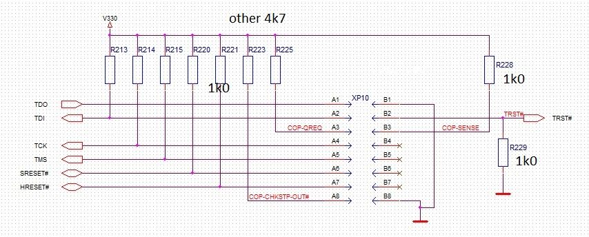

Hi every one,
Programming NOR Flash over PA Flash Programmer Task [CW 10.5.1 > CodeWarrior TAP > Custom Board (MPC8321)] - generate Error:
fl::target -lc "MPC8323-core00_RAM_8323_Attach"
fl::target -b 0x0 0x40000
fl::target -v off -l off
cmdwin::fl::device -d "IN28F128J3" -o "8Mx16x1" -a 0xff000000 0xffffffff
cmdwin::fl::dump -range 0xff000000 0xff00ffff -t "Binary/Raw Format" -o "C:\\nxp\\u-boot.bin"
Beginning Operation ...
Performing target initialization ...
Error: Connect Failed.
Failed to reset the target
[CCS last error: mpc83xx: cannot put the target into DEBUG mode ](CCSProtocolPlugin)

In Configurations
- Connection Type - CodeWarrior TAP
- Target Type - 8323RDB_HRCW_jtag.txt => 8323 (1 1) (2 0x42050083) (3 0xA4600000)
What is the problem?
JTAG_COP.jpgAll ports connect only to CPU (no other resistors).
Thank!
1,971 Views
yipingwang
When you create CodeWarrior project to do flash programming, in Debug Target Settings, please select "Download/Connect" launch configuration.
In your JTAG interface hardware design, please make sure HRESET exclusive to COP/JTAG header: problems arise when the core is reset and the debugger doesn’t know about it.
Usually the debugger will report the processor can not be put into STOP mode.
Please refer to page 5 in the attached PPT.

SergAn
Thanks for the answer!
I found the reason. Probably Accidentally shorted while connecting the TMS and VREF circuits on the CodeWarrior TAP cable. Now the TMS circuit at the TAP output is logic 1 and does not change when trying to connect to my board. Strange, I have always considered Freescale to be reliable, usually all output signals are protected from possible short circuits. Can you tell me which chip in CodeWarrior TAP is broken?
