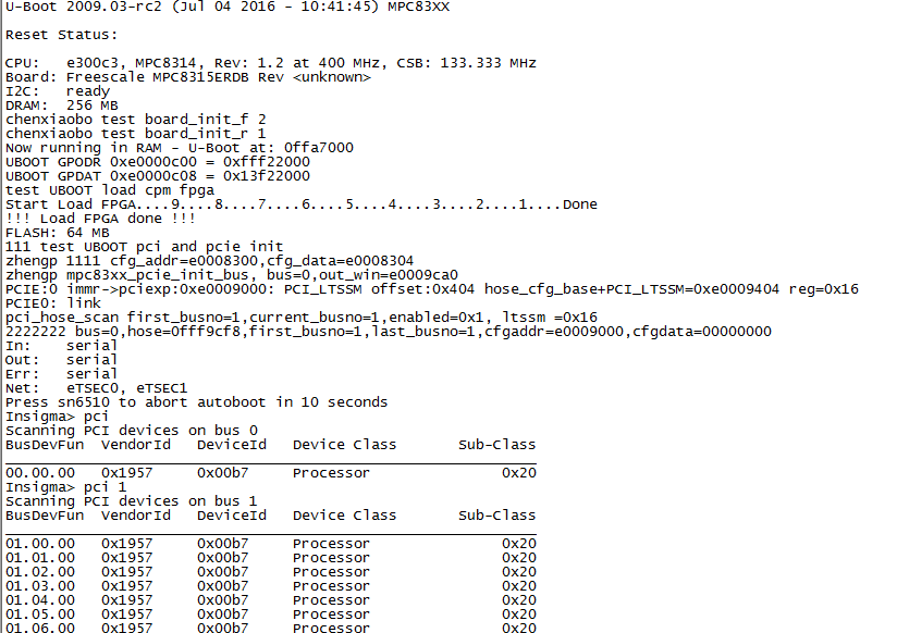

On physical hardware,PCIe 1 connects with PCI device(BCM56134).
When during scanning pci 1 bus,why It can't detect bcm56134?
It print like this:

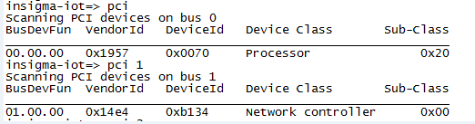

In fact,Should be printed like this:
How to set the PCI configuration space, MEM space and  I/O space?
and Which register are need to set?
Such these Macro definitions,how to set ?
CONFIG_SYS_PCIE1_BASE、CONFIG_SYS_PCIE1_MEM_BASE、CONFIG_SYS_PCIE1_MEM_PHYS、CONFIG_SYS_PCIE1_MEM_SIZE?
CONFIG_SYS_PCIE1_CFG_BASE、CONFIG_SYS_PCIE1_CFG_SIZE?
CONFIG_SYS_PCIE1_IO_BASE、CONFIG_SYS_PCIE1_IO_PHYS、CONFIG_SYS_PCIE1_IO_SIZE?
