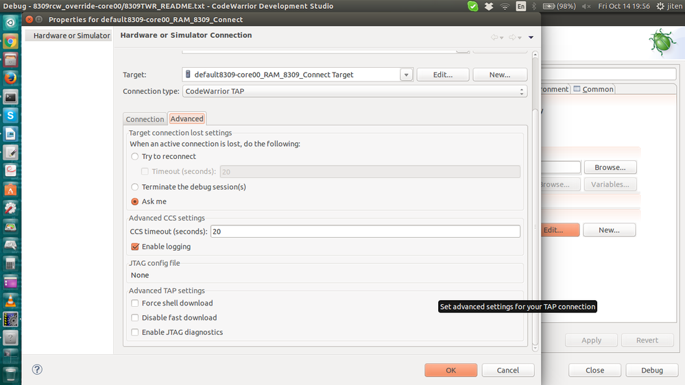

addiyi
Reset delay is set in CodeWarrior (Go to Debug Configurations > Edit > Advanced tab > Reset delay (ms) and set i to at least 2000). In some conditions CW is not able to reset the target and this could lead to that error.
If this is not working, than it is possible to be a jtag hardware issue.
Adrian
6,245 Views
jitenpatel
Andrian,
I am not getting any option for Reset Delay, We have CCS timeout option, that was set as 15 by default. I tried changing it to 20, but didn't work.
I am not sure why it could be jtag Hardware issue as we are able to connect MPC8308 board with the same jtag hardware.
