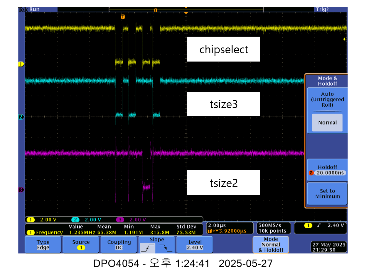

i used MPC8248  without problems for years
this time,  my board need to interface   with   a little endian board  by  external bus
before   my board interfaced with a powerpc family board,  so no problems in endian
it isn't possible to modify software  so my thought is  to use tsize signal to find  8bit and 16bit access,  if  access cycle is 16bit and  i plan to use  byte-swap  in hardware
only byte and half word access are used in software and they are aligned
but when i checked tsize2,3  it dosen't work  in the way i thought
in linux,  with mmapping /dev/mem    i tried byte access but  tsize2( means 16bit access) worked,
i captured the signals  with scope,  all signals are active low from CPLD
i accessed a bus  4 times by byte-read  but  one 16bit bus occurred
how does  the tsize signal  work ?  any information will be of great help

Customer can refer to "8.4.3.3 TBST and TSIZ[0:3] Signals and Size of Transfer" in RM.
