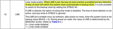

We have a legacy design using MPC555LFMVR40.
The system input is 40MHz clock to the MPC555. In normal startup, the clock of the MPC555 is 40MHz. Sometimes we found the clock output from the MPC555 is 7MHz, which corresponds to a limp mode according to the manual. We checked the manual, and this mode is related to the status of several pins (MODCK1/2/3), and we also measured the status but found no abnormalities.
Could some help me to understand what would lead the chip enter LIMP mode?
I know this part is EOL but we bought stock per LTB that could support our commitment to end customer till 2035. We do need NXP support the investigate on the root cause. Please do the best to give some comments on any possible reason that will cause the chip run into LIMP mode. Thanks!

The Limp mode is entered in case of loss of clock:

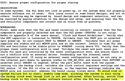

If you take a look at the errata sheet for revision M, there's an explanation (CDR_AR_598) that some boards can be more sensitive to PLL issues. There's a list of recommendations which should help to avoid that and recommendation how to deal with such event:
https://www.nxp.com/docs/en/errata/MPC555MCE.pdf
