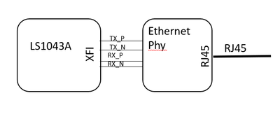

Hello NXP community,
I need to test the XFI electrical interfaces of LS1043. Do i need Ethernet PHY? Is there any COTS adapter/converter available? Please advise me hoe do i test this XFI interface.

June_Lu
XFI is an electrical specification defined in INF-8077. please compare your application with the SPEC.
https://members.snia.org/document/dl/26514
