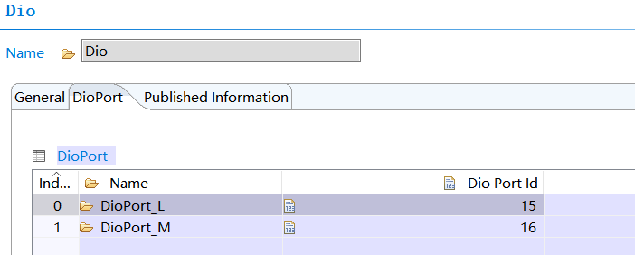

Hello all,
When I'm using EB Tresos to config the DIO, there is a description:
Numeric identifier of the DIO port. Symbolic names will be generated for each port pin id for the pins which being used for configuration. NOTE: Use the following values to configure different ports.
  • PortA=4
  • PortB=5
  • PortC=6
  • PortD=7
  • PortE=8
  • PortF=9
  • PortG=10
  • PortH=11
  • PortI=12
  • PortJ=13
  • PortK=14
  • PortL=15
  • PortM=16
  • PortN=17
  • PortO=18
  • PortP=19
  • PortQ=27
  • PortR=28
  • PortS=29
But when I am reading the MPC5674F Manual, there is no GPIOA, GPIOB or PortA, PortB.
Case:

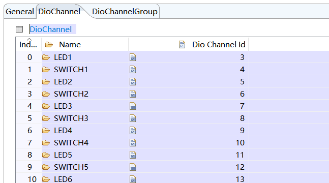

I try to use Pin_179 as Digital Out(LED1), which group should I choose?

what is possible values for Dio Port Id and Dio Channel Id? if for example 0 to 15 then, I think, use
Dio Port Id = 179 / 16 = 11
Dio Channel Id = 179 % 16 = 3

Thank you. The solution can work.
