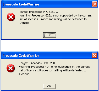

I'm currently running the eval version of CodeWarrior for Power Architectures 8.8.
Installation went smooth without errors. I decided to start as I always do, by compiling the various examples included.
Everything worked, all examples compile without issues. The problem happens when I go to: Edit > Embedded PPC 8260 C Settings > Code Generation > EPPC Processor
At this point, I get one of the below errors:
This happens both with the evaluation license generated during installation as well as with the one downloaded from the NXP website.
Is 8260 separately licensed? I'm surprised this is only affecting this settings panel.
Or is 8260 not supported and was included by mistake?

Thank you June, I have now opened a support case with license team.
1,295 次查看
June_Lu
 CodeWarrior for Power Architectures 8.8 could support MPC8260. Any license error, you could create case for the license team.
