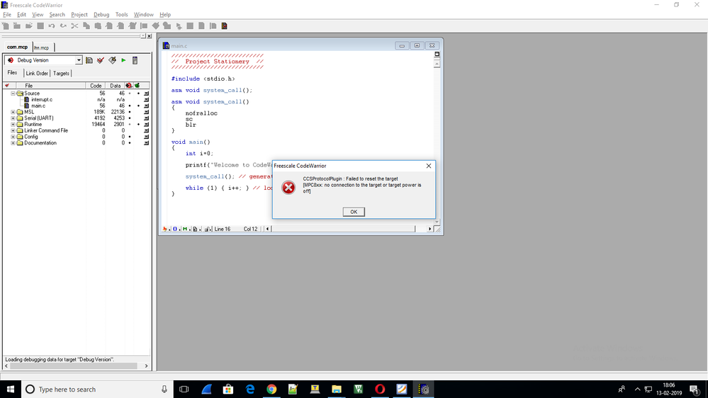

I am using MPC 860 processor.  I could not able to debug the code with Code warrior USB TAP.  Getting an error "Could not set PC to entry point". But unable to correct this. Anybody is there to help?

maheshwarreddy
When we are trying to enter into debug mode that time we are getting the JTAG clcok ,TDI,TDO and reset also then we are getting the error as failed to reset the target .The error is attached below .

maheshwarreddy
Thank you for the reply.
The data pins of the external bus are connected PULL UP  of 3.3volts supply with the 4.7k resistor. But in the development board they are connected to the CPLD  is this makes any difference .Now also we are getting the same error as explained in the above .Whether VFLS[0,1] are in the control of the processor or with the external  events(user controlled ).

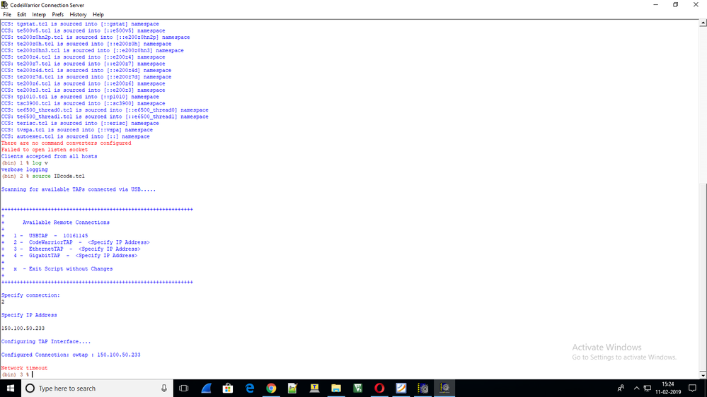

Pavel
Test CCS connection to your board using the following commands in CCS console:
 (bin) 49 % config cc cwtap
(bin) 50 % show cc

maheshwarreddy
i have checked at  ccs.exe by using the above commands ,
after selecting the device and entering ip address of the pc, it is showing connection network timeout. please check the image and help us.

Pavel
Usually similar error message happens if "Software Patch: CW PA v8.8.6 Windows " is not installed". See the following page:
https://nxp.flexnetoperations.com/control/frse/download?agree=Accept&element=6121541
This patch installs driver for CodeWarrior TAP.

maheshwarreddy
we already installed the patch and problem remains same ,
and sometimes it is showing error like
syntax error at line1
