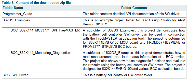

Hi Bart,
I would recommend you using the MC3377x Software driver including example projects for S32K144EVB-Q100 board available at Embedded SW: MC33771/MC33772 SW Driver | NXP
So either change to that hardware platform and use a bread board design connecting the EVBs or the BCC Software driver needs to be “adopted” to the KL25Z.

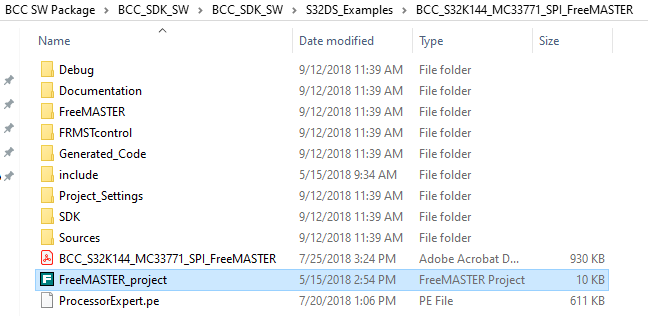

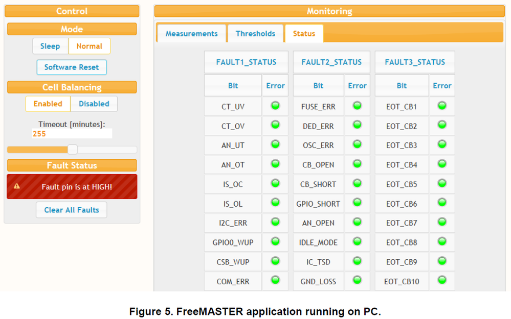

bart1
Dear Jan,
I finally have a working connection between the freemaster example project and the S32K. Problem was that i did not measure the connections of the small jumper resistors after resoldering them, two of them were not soldered properly. The voltage values are now displayed correctly and i can start programming the balancing and SOC features for my graduation project.
Although i am happy that the connection works, i noticed that when i enable balancing by with functions BCC_CB_Enable and BCC_CB_SetIndividual, the voltages drop but the status of the balancing registers is not shown in the cell balancing section of the freemaster application. So i have no way of really knowing which cell is being balanced. Is there an easy way to get this balancing status visible on the freemaster application?
also i have a question about the coding of the balancing feature. Is it correct that i should make a piece of code that compares all the cell voltages and if the difference between highest and lowest voltage reaches a set threshold balancing should be enabled on the highest voltage cell. I could not find anything on stack overflow about comparing more than 3 values so i might be doing something wrong. Again, i am very new to embedded systems and eager to learn.
Thanks again for your help.

jann_
Hi Bart,
regarding the implementation of the cell balancing feature: You are right. MC33771/2 devices can only turn on the balancing for a configurable amount of time. There is no voltage comparison in the device. Therefore, MCU itself must recognize, which cells need balancing. For more than 3 values, you should implement some suitable cycle. You can also try to start with some sorting algorithm (Bubble sort, Merge sort, Quick sort, etc.). You'll find a lot of their implementations online.
You are right that you don't see the finished cell balancing on the left side of the app. However, you are able to check it in the "Status" tab via bits dedicated to CB_Timeout for each cell.
The goal of the FreeMASTER example app was not to cover all the BCC functionality. E.g. Timeout can be set for each cell separately in the device. In the FreeMASTER example, the same timeout is used for all cells. If you want, you can extend the example as you want.
Jan
