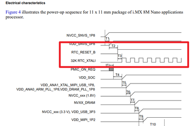

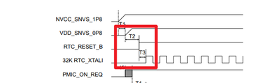

Dear Team,

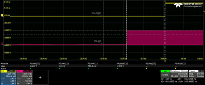

According to the i.MX8MN power-on sequence requirement, RTC_RESET_B must be pulled high before 32K_RTC_XTALI is ready. However, in the PCA9450 specifications, it is noted that 32K_RTC_XTALI is ready before RTC_RESET_B is pulled high. This presents a conflict, as both of these signals are provided by the PCA9450. Consequently, the current measurement results comply with the PMIC specifications but do not meet the i.MX8MN power-on sequence requirement.
We have verified the power-on sequence on the EVK board, and we obtained the same result: 32K_RTC_XTALI is ready before RTC_RESET_B is pulled high.
Please advise.

Dear Sir,
Our observation shows that the 32K_RTC_XTAL is ready before the RTC_RESET_B is pulled high. However, this does not meet the power sequence requirement of the iMX8MN.

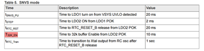

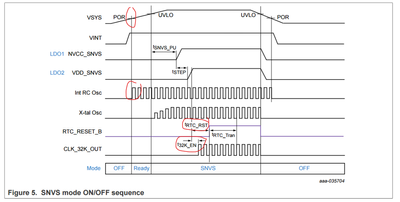

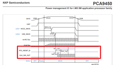

1RTC_RESET_B is pulled high in tRTC_RST after both LDO1 and LDO2 voltage come up.所以该信号跟clock信号没直接的联系
2:PCA9450 outputs the internal 32 kHz RC oscillator initially, while internal counter counts crystal oscillator output in tRTC_Tran after RTC_RESET_B is released.
如果非要这两个信号扯上关系t32k_en < tRTC_RST 所以clock的信号一定在RTC_RESET_B的信号前面出来。
我这里只support PMIC,我不太清楚I.MX的时许是不是写错了还是他另有歧义,比方说我之前说的他认为clock的信号是外部crystal生产的这样的话能讲的通,否则我建议提交一个case去confirm一下这个I,MX时许到底是指什么?

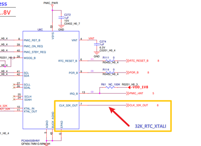

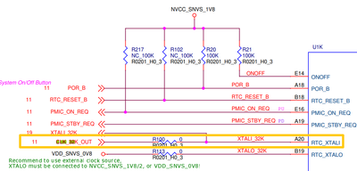

Could you please show the test point for 32K RTC_XTALI in your schematic?
3,806件の閲覧回数
justin_hsieh
Dear Sir,
The 32K was provided by PMIC directly
3,803件の閲覧回数
guoweisun

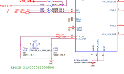

Did you use external crystal on XTAL_IN and XTAL_OUT?
3,798件の閲覧回数
justin_hsieh
Dear Sir,
Yes.

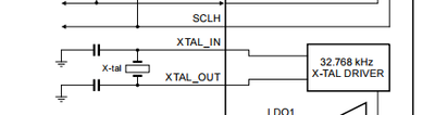

If the counter reaches 100, then CLK_32K_OUT
buffer input is switched to the external crystal oscillator from internal 32 kHz oscillator.
Clock stretch is applied during this clock source transition to prevent unwanted glitch.
If external 32.768 kHz crystal oscillator is not populated, CLK_32K_OUT pin outputs 32 kHz clock from internal 32 kHz oscillator.
