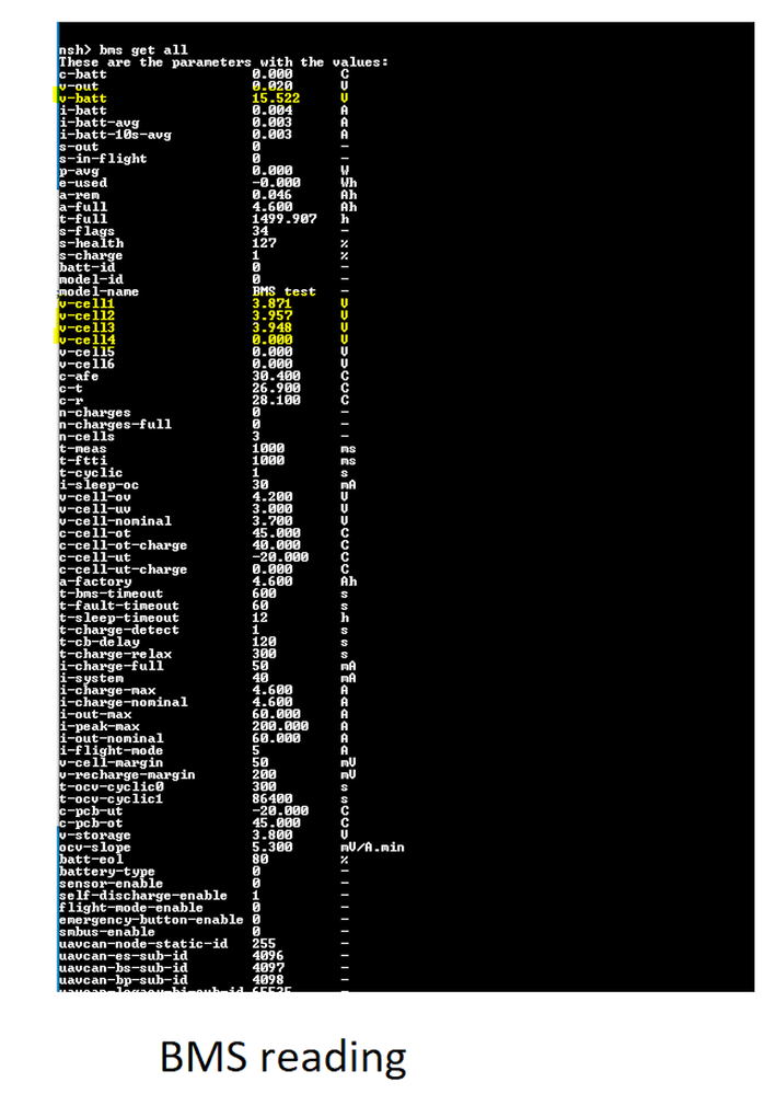

hi,

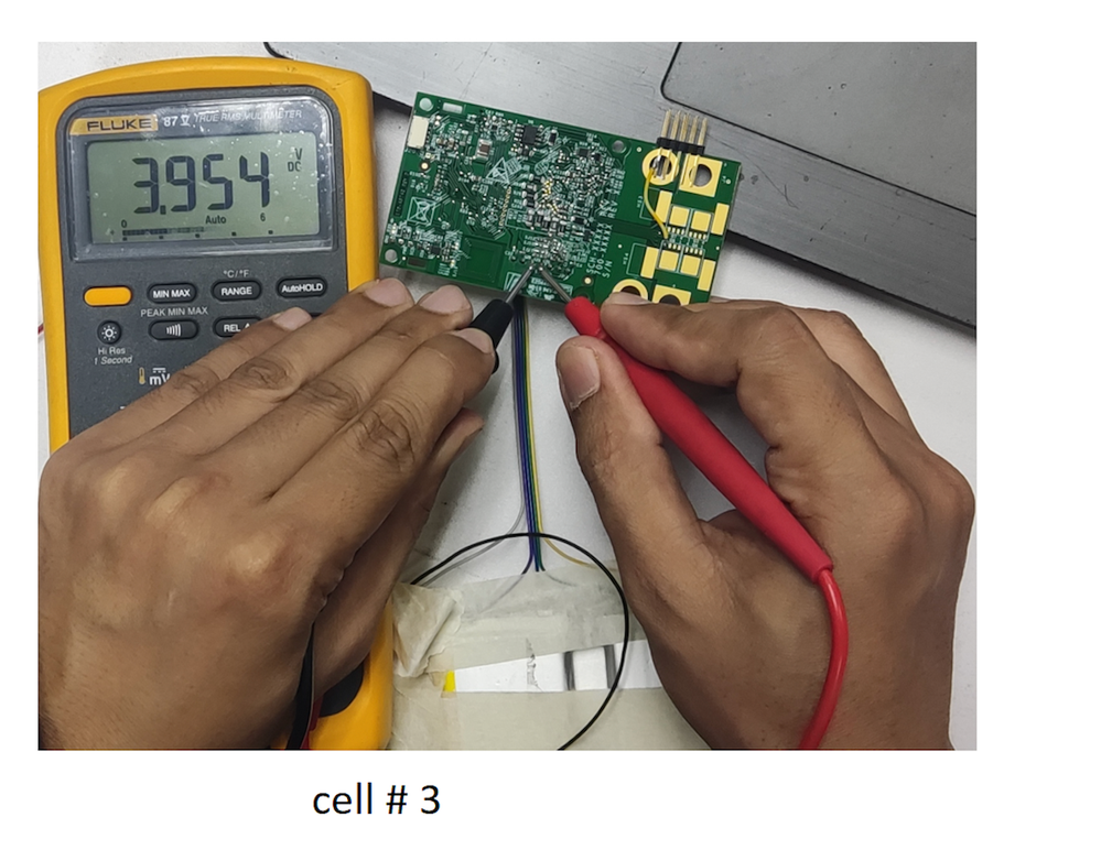

I bought RDDRONE-BMS772 recently. Connected 4 cells, 3 cells display correct voltage but the 4th cell is displays 0v. Pls ref the images, can anyone point me to what else to do to correct this?
BMS display show cell 4 is 0V yellowBMS display show cell 4 is 0V yellow4th cell reading is good from here, 3.6V4th cell reading is good from here, 3.6V

guoweisun
You can try to use 6s in this system to test again.
2,437 Views
suvasis
1.The default is 3 and it is not auto detect..
2. they are working after I set the number of cells to 6.
Now it looks ok after the number of cells are set to 6.

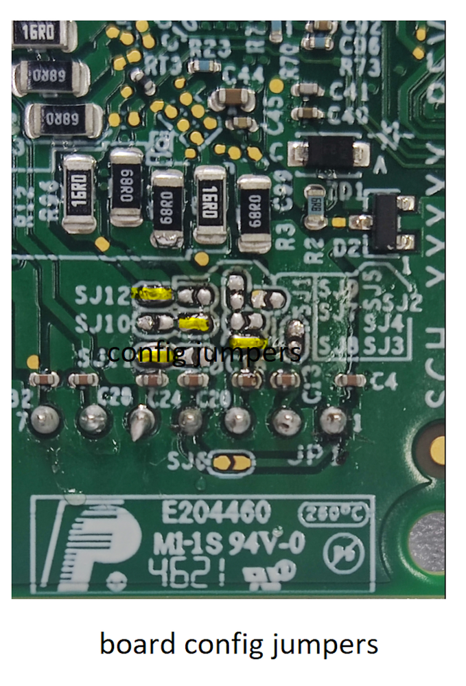

suvasis
also attaching the configurations:
Screen Shot 2023-06-02 at 1.36.16 PM.pngScreen Shot 2023-06-02 at 1.36.22 PM.pngcell 3 reading is 3.6V and bms display also shows 3.6Vcell 3 reading is 3.6V and bms display also shows 3.6V
