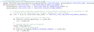

I am using the Example_SW_TJA1145 program.When I use the ChangeToSleepOperation function of the example program to enter Sleep mode, I debug and find that a PO event occurs.Whenever I try to enter Sleep mode I get blocked by the PO event。
Why does this happen and how can I solve it?

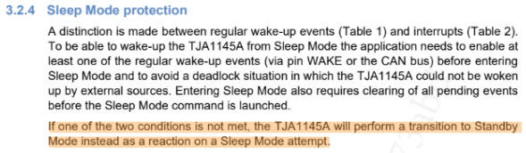

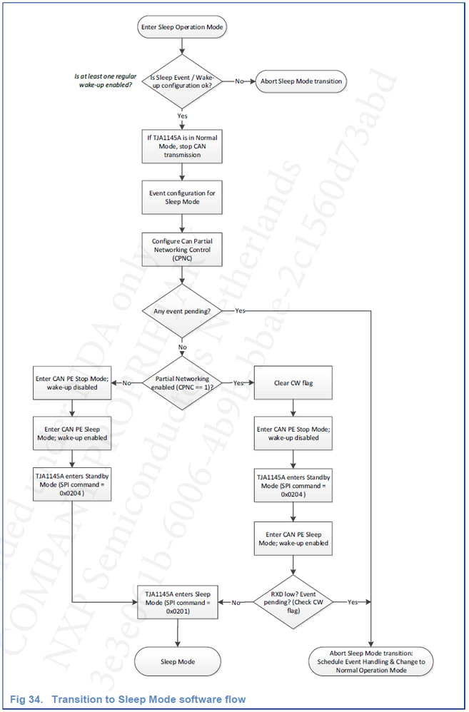

TomasVaverka
Perhaps the Sleep mode entering is protected due to wake-up event is not enabled and/or pending events are not cleared. For more information, please see chapters 3.2.4 and 5.3.2 of the AH1903 (Secure file under NDA).
