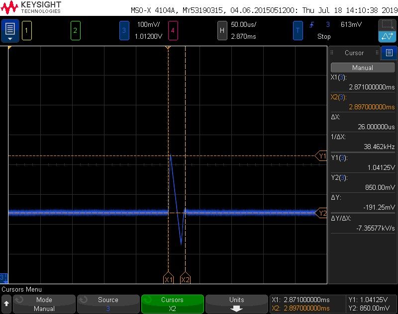

I got a question from SICK with regards to the PF8200. They work on the PF8100 FRDM EVM and have seen the following behavior:
During the power up sequence, some switches have voltage spikes during ramp ups. But the buck converter switch 3 (blue curve) has a spike at the regulated voltage as seen from the picture below:
Now this voltage from buck 3 goes to the i.MX 8M-Mini and it would be helpful to know why this happens. This spike does not happen when only switch 3 is ON and rest of the bucks are off.

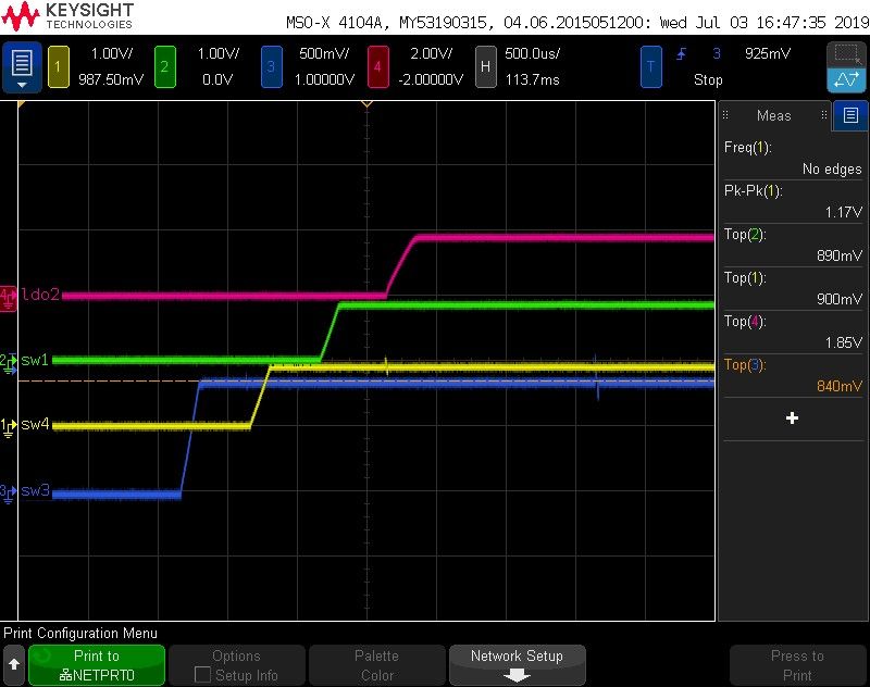

Measurements were done like shown in the graphic.
The first picture is when Switches 3, 4, 1 and LDO2 are measured (other LDOs are off, switches 2,5,6,7 are on). Here you see that there is a spike in switch 3 when switch 4 turns on and there is a spike in switch 4 when LDO2 turns on. It occurs only with buck 3 and 4 and not with any other bucks.

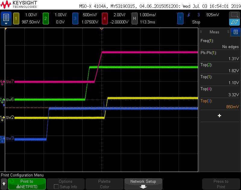

Here you see a spike on switch 3 when switch 2 turns ON. I have used the standard oscilloscope probes here and measured without load. I'm using GND pads close to the signal measurement points to avoid parasitic effects:

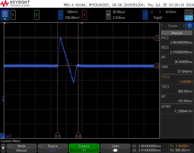

As per your advice in your previous email, I used very short loops between the signal measurement points and the ground points using the MSO4104 scope and tested it without any load. I measured just the switch 3 which had the biggest spike. (Other switches were on as well).
A screenshot of it is below. This spike appears when switch 2 is turned on.
I powered the board from an external power supply port and from the USB port. The spike is there in both cases.
The switches which have the spike are just 3 and 4, the rest of the switches are not affected.
  • In total there are 3 spikes that happen:
    SW3 spikes when SW4 turns on
    SW3 spikes when SW2 turns on
    SW4 spikes when LDO2 turns on.

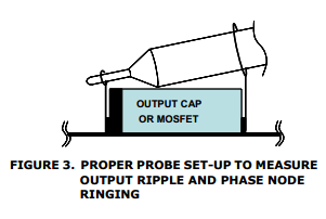

Bernard did a very good point mentioning that customer should use a good probe and use a GND connection as close as possible to the signal measurement point and use a short connection.
I believe that customer is seen this ripple because of the way it’s being measured, please correct me if I’m wrong, but I think that customer is measuring using an oscilloscope probe connecting the GND connection to one random point of ground in the board and the end of the probe on one point of the SW3 output of the board, right?
Now, remember that Buck regulators as SW3 are high speed switching signals, so care must be taken when measuring this kind of signals, just by measuring using a close GND reference on the board could not be enough to eliminate the ripple out of the measuring, you would need to reduce the space of the measurement between the GND and the end of the probe by placing a cable around the probe ground closer to the end as mentioned in the following image:
Please confirm when customer make the measurements using this method and send me the updated waveforms.

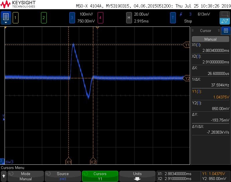

I did the measurements again as you suggested in the graphic yesterday and I am attaching two results here. One measured wit thr oscilloscope probe connected normally  by using a close GND reference on board and the second one using a short measurement path between signal and ground.
1. Normal measurement using a nearby GND reference on board
2. Switch 3 signal measured across the capacitor using a small measurement path. The spike on this switch 3 still exists (switch 2 turning on at that point)

This is the response I received from the Apps team:
This is a known behavior that we found recently,
See attached Power point , it describe the behavior on the production silicon (official errata is being put together as we speak).
however, on B0 silicon , the behavior is present on different combinations of regulator being enabled.
summarizing the behavior:
this is related to the routing of the bias signals of the SW regulators, LDOS, and their OV/UV monitors. so when these signals are running parallel to each other without any shielding, the glitch will be present when the regulator is enabled, or the OV/UV mon is enabled (which typically happen together when the Regulator is enabled, but the OV/UV monitors can be disabled and enabled independently if needed)
in your plot, what is happening is that the regulator are creating this cross talk when the other regulators are being enabled in the sequence.
on C0/C1 production silicon, we work to fix this issue, unfortunately there is one condition we did not spot during the fix and hence the errata on C0 silicon.
