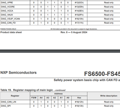

Now we are working on SBC FS6513, and MCU is S32K324. and regarding the SBC fault detection, I have following questions:
1)what kind of SBC fault shall we detect in normal case? such as self-test fail, communication error, over voltage, under voltage and so on..
2)how can we detect above fault(DTC report is required), only read DIAG register is enough?

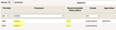

first please let me inform you, that for the the S32K3xx MCU family the recommended SBCs are newer FS26 and FS23. Please refer to this link.

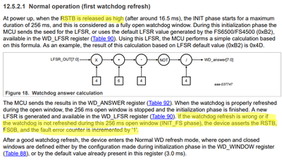

[A] In Normal operation, please check the RSTB, FS0B pins, depending on the WD_IMPACT_1:0 bits setting. If default, then only the RSTB pin.
Then you can periodically check all the DIAG registers for faults.
[A] Yes, only the DIAG registers are enough for the FS65.
