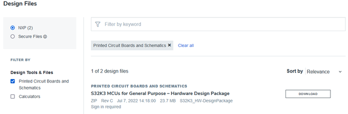

mogilipuri_harish
hello daniel
1.how to configure the GPIO's 5V logic level? is it just we need to connect 5V supply to VDD_HV_A or do we need to any configuration??
2. how to configure the PWM output signals? we need to configure the PWM output signal with 75% duty cycle with 16Khz .
2,688件の閲覧回数
danielmartynek
Hello @mogilipuri_harish,
1.
Yes, just connect the VDD_HV_A to 5V source.
Refer to S32K3 Hardware Design guidelines in
S32K3 MCUs for General Purpose – Hardware Design Package
https://www.nxp.com/products/processors-and-microcontrollers/s32-automotive-platform/s32k-auto-gener...

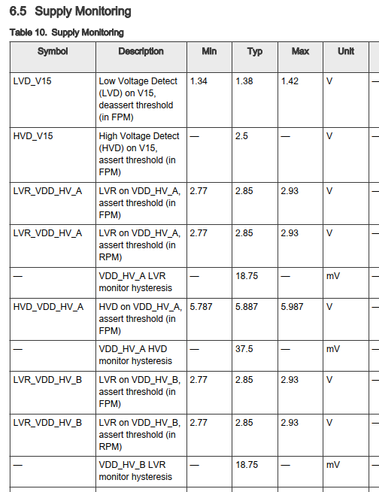

2,728件の閲覧回数
mogilipuri_harish
hi daniel,
we are using VDD_HV_A = 5V
as per the datasheet max = 5.5V  typ = 5V min = 2.97V
the voltage max tolerance is 10% and minimum tolerance is  40.6%
VDD_HV_B = 3.3V
as per the datasheet max = 5.5V  typ = 3.3V min = 2.97V
the voltage max tolerance is 66% and minimum tolerance is  10%
this means this much tolerance will be there??
2,725件の閲覧回数
danielmartynek
Hi @mogilipuri_harish,
Yes, that is correct.
The lower limit is becasue of the Low Voltage Reset + some margin.
