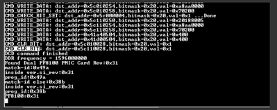

Hi NXP,
We are developed custom imx8qm-mek based board.
Imx8qm-mek uses pf8100 and our custom board uses pf8200.
Please let help me for board-bring up with pf8200.
Error: Found Dual PF8100 PMIC Card Rev:0x31
PMIC INVALID!
PMIC INVALID!
Please let me know where to change pmic settings.
we are using NXP.imx8-SCU DDR Test tool.
Following changes are made.
I made some changes in platform/board/mx8qm_val/board.h
#define EP_PROG_ID 0x49AU  before--> 0x0417U
#define EQ_PROG_ID 0x38BU before---> 0x0418U
and platform/board/pmic.h
#define PF8100_A0_REV 0x31U before--> 0x10U
Please let me know what all changes has to be done for PF8200 in scfw version 1.2.1
Please find the attached screenshot from ddr_tester
Please reply ASAP, your solutions are well appreciated.

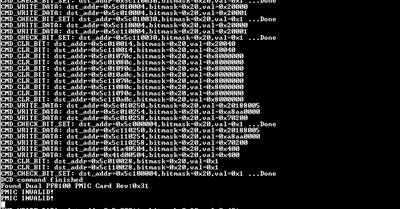

Hi Igor,
Thanks for your reply.
I am using scfw_1.6.0 version firmware i changed only PMIC_TYPE=PF8200
Please find below logs for PMIC_TYPE=PF8200 in pmic.c file i.e boar/pmic.c
Still i am getting PMIC INVALID!
Please let us know, how to enable PF8200 on IMX8QM.
Thanks and Regards
Subramanya N  M

rahulM
Hi Igor,
Thanks and Regards
Subramanya N  M
