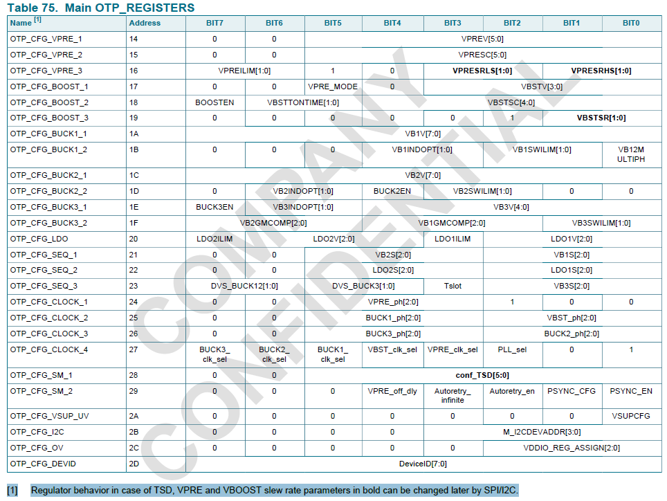

Fail-safe OTP_REGISTERS registers cannot be changed later during the INIT_FS phase.
From Main OTP_REGISTERS, only regulators behavior in case of TSD, VPRE and VBOOST slew rate parameters can be changed later as shown in the FS84/85 Datasheet rev. 3.1 and below.
So to answer your questions in detail:
1. No. The Watchdog mode (Simple or Challenger) cannot be changed later during the INIT_FS phase.
FS85 watchdog must be configured to "Challenger WD" by OTP (WD_SELECTION = 1) for ASIL C or D safety applications.

2. No. The Fault recovery strategy cannot be changed later during the INIT_FS phase.
If the FS85 is used in combination with NXP S32x 16nm MCU and the FCCU monitoring is enabled, the FS85 Fault Recovery feature should be enabled by OTP using FLT_RECOVERY_EN OTP bit to benefit from the MCU Fault recovery strategy.
3. No. Both Autoretry_infinite and Autoretry_en cannot be changed later during the INIT_FS phase.
