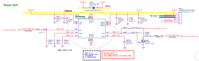

According to the spec, the output voltage shouldn't drop to 0V when the OCP happen. I set the OCP to the 3.3A and drain 4.8A from the output. I saw the output voltage drop to 0V. Is there anything I can check?

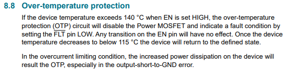

TomasVaverka
I suppose that the over-temperature protection was activated.
Also make sure that the input voltage remains stable and within the specified range during the overcurrent event. If the input voltage drops significantly, it may affect the output voltage.

wizleu
Hi Tomas,
thanks for the reply.  Here is the waveform(VSYS_5V=VIN,  5V_OUT= VBUS)  and the circuitry. It seems that our input voltage didn't enter the UVLO range when the OCP happen.

TomasVaverka
Thanks for sharing additional information including the schematic and waveform.
Based on that and after my discission with our application engineer, it is normally OCP function, the NX5P3290 controls the MOSFET Rds to limit current under OCP happen status.
You can assume Vin=5V if current = 3A Rds=35 mOhm(type) Vout=4.895, if Vin=5V current=4.8A (trigger OCP and not trigger SCP/OTP) Rds will rising Vout will drop until Vout=0V.
