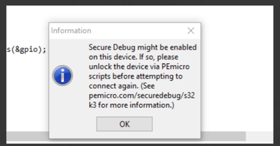

  • Board 1 : While flashing the MCU S32K322 using S32DS (Version 3.4). We had used PEmicro Multilink Universal as interface for flashing.
After debug configurations were done, and started the debug, the above message was displayed. After that, we tried selecting target device as "S32K322-SECUREDEBUG", but the option was not available
What could be the possible reasons and solutions to this? Need your support for it.

Here is observations related to MCU :
MCU (S32K322) boot is not happening.
External crystal frequency (16Mhz) is not coming.
While flashing MCU - Following message shown
Reset script (C:\NXP\S32DS.3.4\eclipse\plugins\com.pemicro.debug.gdbjtag.pne_5.1.7.202112141853\win32\gdi\P&E\supportFiles_ARM\NXP\S32K3xx\S32K322.mac) completed.
BusFault: An imprecise (asynchronous) data access error has occurred.
HardFault: A fault has been escalated to a hard fault.
Please let us know the possible reasons to fix the issue.
