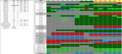

4) With cell balancing off for every cell, and measuring directly at the copper floods labeled on the attached screenshot (Cell 1 reading is taken CT_REF to CT_1, Cell 2 is CT_1 to CT_2, etc.), I get the following data:
 Cell Controller readingDM3058E reading
Cell 1:4.050 V4.0315 V
Cell 2:4.003 V3.9793 V
Cell 3:4.007 V3.9830 V
