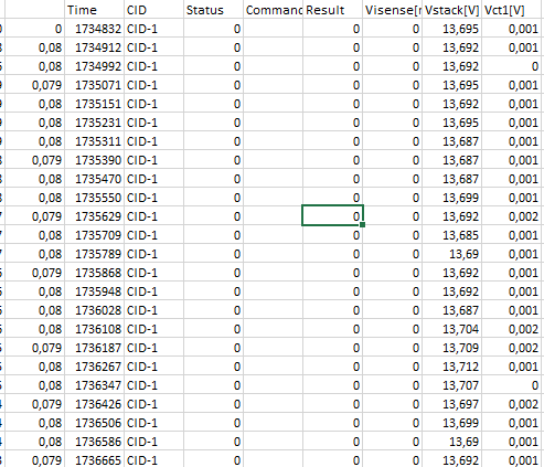

I am using the FRDM33771 with SPI connecting.
After running some tests with the evaluation GUI I want to export the data to excel., however the are a lot of data samples.
Is there a way to adjust the `sample rate to take a data sample for instance every 10s?
As you can see, now every 0,08s a data sample is taken.

Hi Davinio,
Unfortunately the Evaluation SW / GUI does not allow to do that.
You will have to write your own SW to do that.
It would be possible to e.g. modify the KL25Z SW from the Evaluation SW to only measure / send data at a lower frequency.
