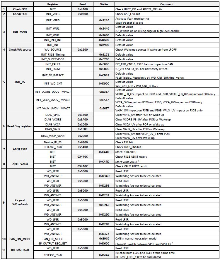

When I power on the FS4500 ,It only lasts 1.3s then shuts down . Our team can only use it's debug mode now.
I write three instructions. first I use DSPI to config the  INIT_INT register to let FS4500 in normal mode(MSM state machine).then config the  INIT_SF_IMPACT register to close the FS mode ,last config the WD_WINDOW register to close the watchdog.
What should I do to solve this problem , I used the example code in this website however no use. The DSPI we use is DSPI_2,I promise that DSPI is ok.

I find it is the Feeding Dog‘s Problem ,Now I have solved this problem !thankyou

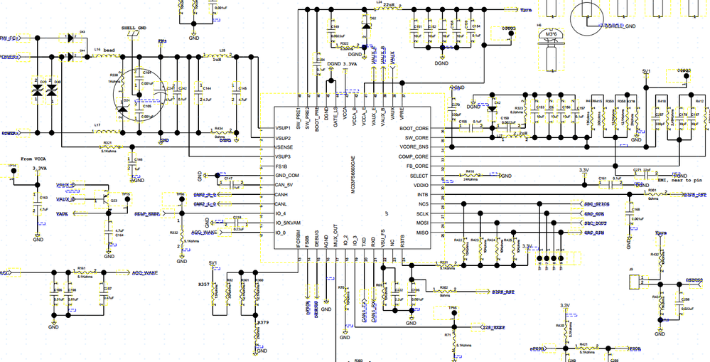

  firstly, I just try to power on the SBC to make it working continuesly , However it only lasts 1.3s (Vpre ,Vcore has high level ) and then power down (the SBC has no electricity).  So I initialize the main state machine INIT_INT register trying to extend the time.but  no use.So I decide to use the official example nxp offers.also no use.
  the link you give to me is locked ,I would appriciate it if you unlock it for me.
  I use this demo code in the below link.
MPC574xP-MC33FS65xx / MC33FS45xx Demo Code
  the schematic I want to use is this one given by a reply from another comments .step.png
But it is the next step to realize the state machine and dialog . I think I should make SBC having power longer to provide power to MCU, such as 8s before I feed the watchdog.I don't know this problem is the software problem or the hardware problem.

For hardware I will double check your schematic,please send to me.

Thanks for reply,I have founded the problem which is because that I forget to feed the dog in the 256ms windows for 6 times.

   1.how can I success to feed the WD? As you know,WD_WINDOW is 3ms ,only 50% is the "open" window which can succeed feeding the WD.Front half is "close" window (feeding wrong WD,WD ERR COUNT + 1),It may be Feeding WD Front half that made the fault counter =6,then the state turns into the deep fail safe mode.
  2.In order to exclude the Feeding WD problem, I feed the 256ms first WD and config the WD_WINDOW register to close the WD in normal mode.However It also turns into deep fail safe mode because the fault counter becomes 6.Can I say that
it is not the Feeding watchdog problem?
  3. How can I find the exact problems that made SBC turn into deep fail safe mode ?After Power on reset ,It is only 1.3s,and then it turns to DFS.

Could you please send your schematic firstly?

Hi,Sun
I want you to show me if there is anything wrong with my hardware.In my code, the mode 6503 read when the power is on is the normal mode, so I cannot initialize the register normally.
