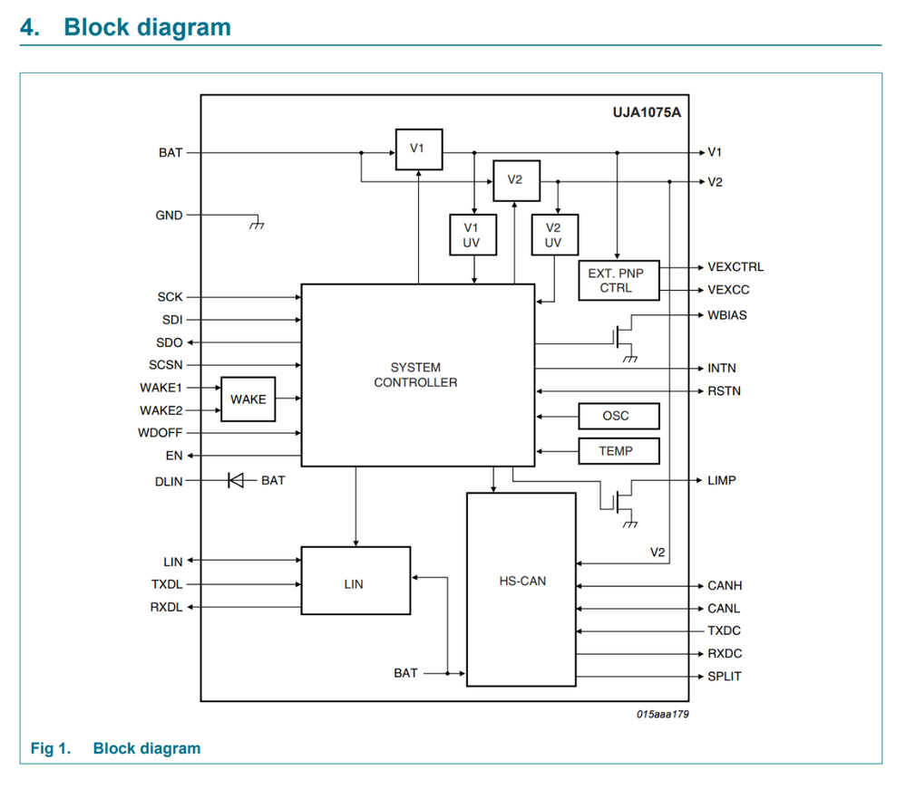

According To Datasheet And Following Diagram Of UJA1075ATW Here Is Not WDI (Watchdog Input) To Be Periodically Kicked. So We're Confused About The Mechanism Of Watchdog Timer. In Our Case We Want To Apply Watchdog For A System Supervisor To Monitor MCU's Status. IF MCU Behave Abnormal Then Reset MCU For 3 Times. After 3-Times Reset Pull EN Pin As High To Turn Off External Gate / Switch For A Prevention That A Power Source Cause Malfunction To Relay / Motors Upon Seat / Sunroof / Mirror.

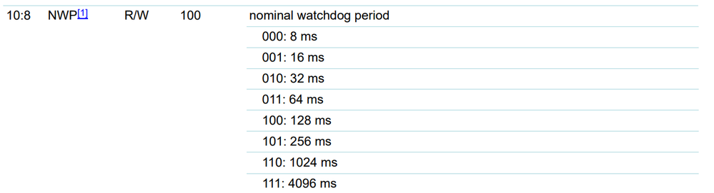

2-2 We Don't See Any Details About The Built-in Watchdog. First General Watchdog Required To Be Kick But The UJA1075 Seems No WDI (Input Pin). Our Problem Is The Watchdog Can Be Configured By SPI To Register For 3-Time Reset Mechanism? (Enable RSTN Pin To Reset External MCU For 3 Times)
Looks Like Dog Kicks Are By SPI TO NWP. Problem Is Here Is Not Register Address Definitions In Datasheet.

4. Here Is 2 Sets Of Wakeup Pins. What Do Them Purpose On? Any Differences?
5. What Is The LIMP Pin For? I See A Description In Datasheet Tells LIMP Is For Overtemp Protection Use?
6. Here Is 2 Wakeup Pins Input To SBC. I Wonder What Situation Will Apply 2 Wakeup Pins?

The only difference between the UJA1075ATW/5V0/WDJ and UJA1075ATW/5V0/WD,1 is manufacturing site. From the application point of view there is no difference.
As for the watchdog configuration and behavior, please refer to the UJA1075A datasheet (Chapter 6.4) and AH1002 (Chapter 3.1.2) that was sent to you internally (Case #00184627) yesterday.
I strongly recommend to take a closer look at the AH1002 where you should find answers also to your remaining questions. If not, please update the Case #00184627 or this thread.
